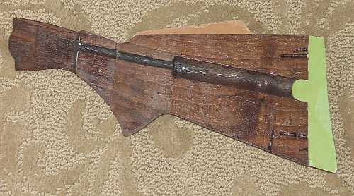

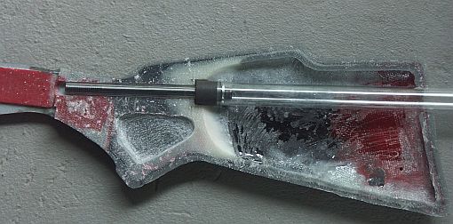

SCHUETZEN - Here's the difference in stock bolt angles between the TCR-83 and TCR-87.
The top photo is for an 87 and the bottom is for an 83. The top photo is half the stock I replicated in fiberglass for a 87 and the stock bolt exits the stock higher than the bottom photo which was the stock from a 83 which I made the mold to fabricate the above stock. The difference in stock bolt angles may be an inch or less, but the two will not intercange. Otherwise the 83 and 87 stocks fit to the metal the same even though the drop may be different. - DON

bottom photo

SCHUETZEN - The bottom photo somehow got out of proportion as it has the same outline as the fiberglass one. However, it does show how the 83 stock bolt hole would exit in the middle of the butt plate and the one for the 87 is closser to the top. I have one TCR-83. I bought it used and at least the seller said it was an 83. Its serial number is 9,000+. I have four TCR-87's. The serial numbers on two of them are around 13,000 and of those I bought new so I know it is an 87. The other two have serial numbers of around 16,000. My 83 has double triggers and my 87's have single triggers. I have a friend who says he has an 87 with double triggers but I think that is uncommon. It also has a stock with real nice wood and a cheek piece. After breaking a stock on one of the 87's from too much 10-ga mag and .50-140 shooting, I sent it back to Thompson Center for a new stock. They gave me one for free! The new stock has a cheek piece and is shorter like for double triggers. It also has a lot of drop. However, it has the correct stock bolt angle for an 87, and it does not appear to have been modifed. Also, some 87's, called the Hunter Model had uncheckered stocks with more drop for shooting with shotgun barrels. - DON

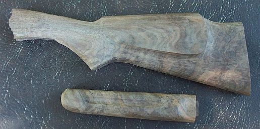

Here's the duplicated buttstock and one of the forends from Macon. The original had no cheek piece but they put one the duplicate at my request. I will probably cut it down a little in both length and height. It is now at a local gunsmith for final inletting. Again, the wood is from a dead tree my son-in-law found on their acreage.

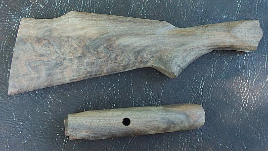

« Reply #12 on: August 28, 2010, 07:33:43 AM »
Here is the other side of the buttstock and another view of the forend.
