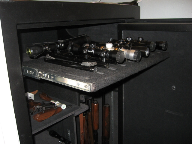

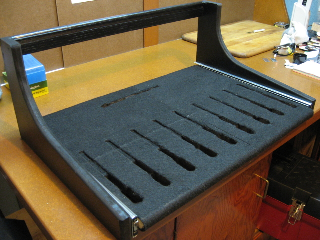

I made a drawer instead of a rack.  It goes on the top shelf of my safe.
I figured out about the best spacing for my barrels with scopes, since all could potentially wear one.  Then I used my router to put a channel for the barrel to rest in and a slot all the way through for the lug.  There is room here for six 10" barrels and four 10" to 14" barrels.  I used good quality heavy duty drawer glides which provide full extension.
The rise at the back of the frame is so I don't have to fasten it to the safe.  It just sits on the top shelf and the rise rests against the roof, preventing it from tilting when all the way out.  The drawer and the sides are 3/4" MDF and the rail across the back is oak.
I spray painted black the parts that would be exposed and then covered the drawer with black felt.
Here is what it looks like in the safe.
As mentioned, the drawer extends all the way out but I only pulled it out part way for the picture.

Tell me about it.  I built this and thought I was golden with a couple of empty spaces for "future".  Well the future is now and I've added four more pistol barrels and two carbine barrels!!!

      My barrel rack is also much like Curtis's if you insert "crude" in front of mine.  Very nice job there Curtis.  My safe must be shallow, cause a scoped 14" barrel won't fit in mine.

Thanks for the kind words there, Walt.  I just love to build stuff, that's all.  Any excuse will do.  My safe is an "American Eagle" by Cannon safe.  I bought it on sale for $599 at Academy Sports a couple or three years ago and I'm glad I did.  I'm now seeing it for $799 "on sale".
I'd like to have a second shelf below this one, but my shotguns are too tall to allow it.  Maybe I need another smaller safe for the shotguns so I can accomodate everything.  I've got a whole spare bedroom dedicated to my shooting and reloading hobby and I'm running out of room!!  I guess it's time for some more planning.

I'd like to add a "nice job" there also, Curtis!!
I'm a "rough carpenter" so jobs like yours seems unattainable to me.
Congrats.

Don't feel bad sweetwater, I'm a cabinetmaker and way too anal too be a very good framer.
That does look good Curtis.
