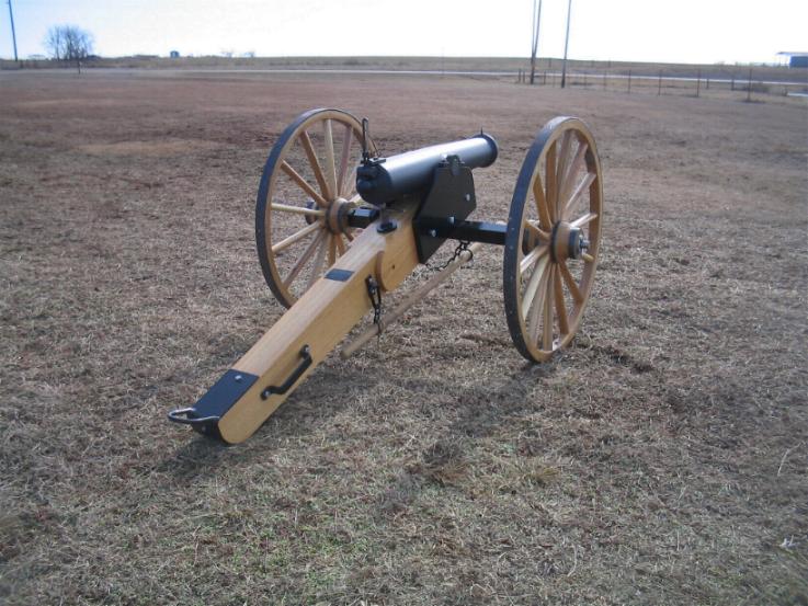

« Reply #17 on: July 25, 2010, 12:19:34 PM »
You asked for a picture. Here it is.
