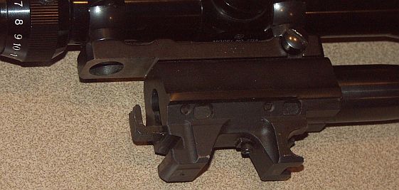

« Reply #3 on: July 21, 2010, 07:27:24 AM »
I really like peep sights. Only had one on a Marlin .45-70 which I bought aroung 40 years ago. My son borrowed it so I temporarily put a scope on it and it was no more accurate than with the peep sight. During the past month or so I fixed up an old Sheridan are rifle for my grandsons. In the process I had a peep sight added which is a big improvement over the open sights it had when I used it as a kid. It is easy to shoot accurately with the peep. I've also thought about a peep sight for a TCR but never went through with it. If I do, I will have a gunsmith make up a bar to screw to the top of the monoblock similar to the Leupold scope mounts and have it cantelever back over the action. I think it's better if a peep is a little closer to the eye rather than forward like an open rear sight. I know that with a rifle barrel the Leupold mounts are supposed to cantelever over a rifle barrel, but I put them on backwards since they look better. However, they need to have a little metal milled off in order to fit that way or the action will not close. This is not a problem with shotgun barrels as the monoblock is higher. Anyway, below is a photo and I would do the same for a peep sight and probably use one of the ghost ring peep sights which are expensive but very compact. Also, I think a post front sight is better with a peep than is a bead front sight.
