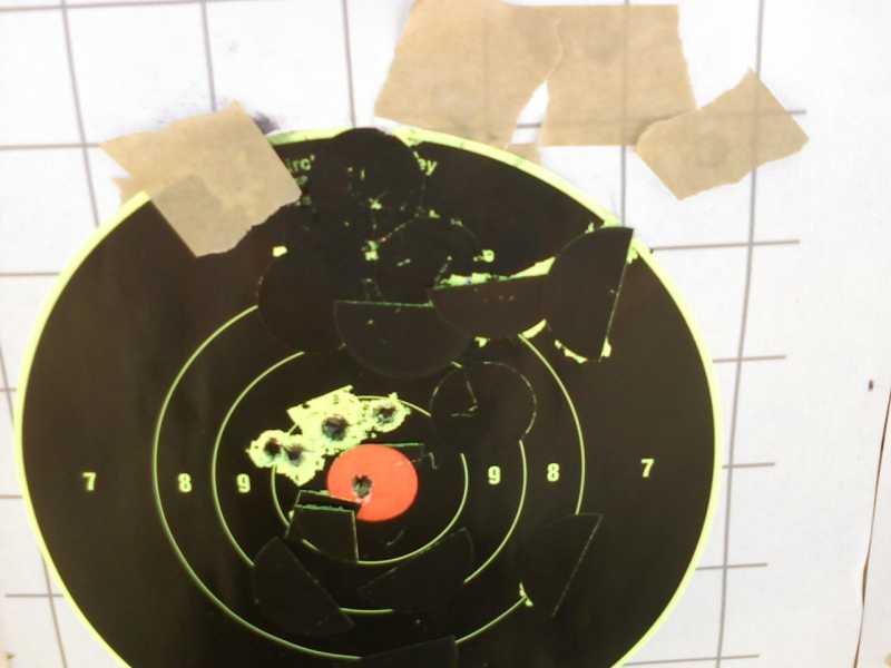

WMR and 105-grain Speer
Made it to the range the first thing yesterday morning and set up the Chrony.  My objective for the day was to work towards a successful load using 243 Winchester cases, WMR (Winchester Magnum Rifle) powder, and WW LR primers along with Speer’s 105-grain Hot-Cor bullet.
Researching my manuals I found loading data for Hornady’s 105 grain A-Max bullet.  I used the data as a general guide by started low and stopped just .7 grains short of the listed maximum.  My goal was to meet or exceed 2800 fps from Remington 788 with a 22-inch barrel.  This is a low price rifle, I paid close to $100 new for it in 1979, and it had a 4X scope on it.  The rifle is equipped with a Bushnell Banner 3x9 scope.  The scope was rebuilt by Bushnell under warranty after I took and fall on snow and ice covered slope.  Before yesterdays shoot I had it sighted in for my 80-grain varmint load.  I adjusted the scope up a couple of inches but the windage was okay.
Thanks to john keyes and fastchicken I had a feel for factory sporting rifles with a 22-inch barrel velocity.
The weather; during my morning shoot the temperature went from 70˚ to 85˚, RH went 51% to 37%; the wind was steady at 4MPH with Gusty 11 all morning.  I could feel the gust push against me.  The wind was the biggest negative because it was hitting at approximately 90˚ then shifting to 180˚ and then back to 90˚.  Just a little bit squirrelly.
I started at 45.5-grains with a velocity of 2745.  The Chrony was setup about 15 feet from the muzzle.  You can add about 14 fps for this round to give a muzzle velocity of 2759.
I had five bags of loads which progressively increased to within .7 grains of the published maximum.  All rounds function without a problem and there was no primer issues.
I was meeting or exceeding my 2800 fps goal by the second bag.
My final bag gave me an average velocity of 2886 or approximately 2900 fps at muzzle.  The picture was from the final bag.  I am happy with the results and will not push the load up anymore.  I have some new WW bulk brass that I will load a couple boxes out for deer hunting.  My comfort level is high with this 105-grain load.
