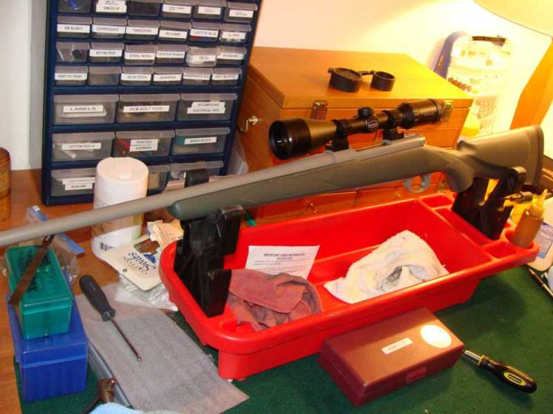

I finally have completed my pet rifle project.  This beauty started out as a reg Win 70 stainless classic in 30-06. It had the ugly black synthetic stock on it.  I sent it to Hill Country Rifles for their accuryzing package and we decided to add a McMillan stock with the Edge technology to keep the weight down.  I got the rifle back when I returned home from my latest deployment back in November. I had it transferred to my local FFL who sells a few guns but his main business is Duracoating. He offered to coat it for free and so I had a decision to make....What color do I go with? I kicked the idea around for a few months and finally decided on Magpul Flat Earth.  I am really happy with how this project turned-out.  I have just a few more "finishing touches" but it is ready to hunt as is.
   I shot it at 60yds a few days ago to get it on paper.  I used Hornady factory ammo with their 180gr Interlock SP.  This is the same ammo HCR got 5/8" groups with at their facility.  I'm not a very good shot, but it would nearly stack the shots at 60yds.  It was getting real hard to tell if I had hit in the same spot or if I had missed completely. P.S. I didn't miss.  ;)
  The scope is a Kahles Helia KX 3.5-10x50 and the rings are the solid Talley lightweights.
Thanks, Dinny

It's my honor!  I just loaded up some 168gr Berger VLDs using their own reloading guidelines. The bullets loaded .010" from the rifling shot into 1/2" at 100yds. I'm gonna try another 6 rounds loaded .005" longer and shorter to see if there is a noticeable difference.  I figure it's grouping great now, but what do I have to lose by loading 6 more to find the ultimate sweet spot.
BTW, I had to change the scope rings to Talley's signature series rings and bases. The one's pictured didn't mate-up well enough for my liking.  Talley made it all good though.  :)

I had to make a few changes; the scope was replaced with a Leupold VX-3 with CDS and the loads tweaked. Finally everything has come together like one happy family.  ;D  I love the rifle and the scope and the rifle absolutely loves those Berger H-VLDs! Today I shot 3 into 5/8" at 150yds. When I get more time I'm going back farther and farther, I think this load will hold up for many more hundreds of yards.
This one ain't for sale, it's a keeper!!!  ;) :D ;D
