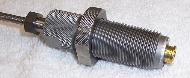

I just started to load .357 Mag.  The only brass I could find was some JAMISON BRASS . When I got it was under sized out of the box. I loaded it with cast bullets and light .38 special loads. After firing it is now two large ,inside diameter. The  140 GR HP/XRP Hornady will just slide down into the case after running them through my sizing die.

1. When you say under size, do you mean length or diameter? As long as the cases are all relatively the same in length, they should be OK. If they were undersized in diameter, did you expand the brass before loading or bell the mouth and just force the bullets in?
2. Are you sure you are using the sizing die to shrink the case back down? If you are then the wall thickness is very thin - more than likely too thin to be safe with any thing but the lowest pressure rounds. Double check that you are really using the correct die for sizing.

Had a somewhat similar experience with 357 Maximum brass from Jamison. First time in my life that I am able to put a factory brass into a sizing die with my bare hand and not have any contact.
The Jamison OD measures .368" at the case mouth and the new Remington 357 Maximum I have since started using measures .373" OD.
There are a few other issues in quality I found but your question is just about brass OD size.

You hit it tho od of the .357 is suppose to .379 according to Lyman. thease are .374. Junk I will never by another peace of Jamison brass!
