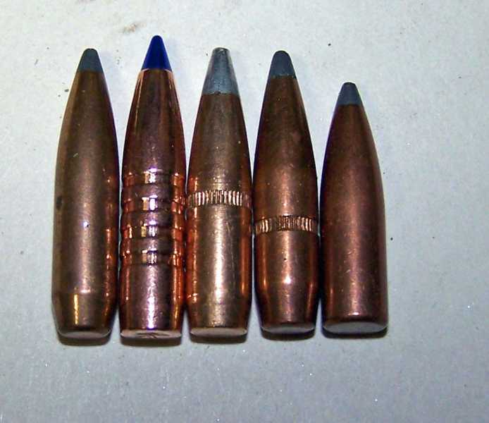

The 150-grain TTSX has to be one long bullet.  I am including a picture comparing the length of the 130-grain Barnes TTSX (blue tip) with a 150-grain Sierra boattail, a couple 140-grain bullets, and a 130 grain Hornady.
On the fourth of August I went out and test fired some 130-grain Barnes TTSX bullet.  A very accurate bullet indeed.
