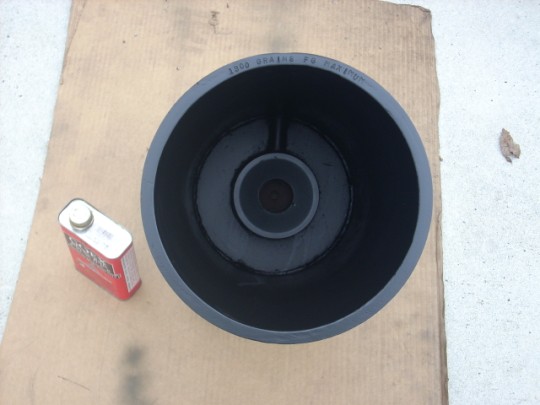

« Reply #8 on: May 11, 2010, 05:15:55 AM »
Joe,  Here's a pic of the chamfer I used.
