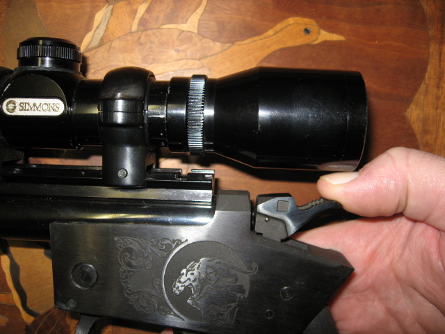

Here is my small to normal size thumb (as far as I'm aware, I haven't gone around comparing) and an old style Simmons with Weaver mount and low height Burris Signature Zee rings.
Yes I can get it on the hammer, but with very little purchase.  I don't like that.  To me pulling the hammer back, whether at the shooting bench or in the stand should not be a dexterity test.  I like the lowest rings I can get away with and hammer extensions don't bother me, so that is my solution.  If high rings don't bother you and the idea of a hammer extension does, I'd say higher rings is the solution.  If wedging your thumb between the scope bell and the hammer doesn't bother you then you have the best of both worlds.
Curtis
P.S.  Sorry for straying slightly off topic as the OP was asking for "who makes" not "pros and cons" but I think many (including the OP maybe) could benifit from seeing this issue from both sides as it does come up quite often.
