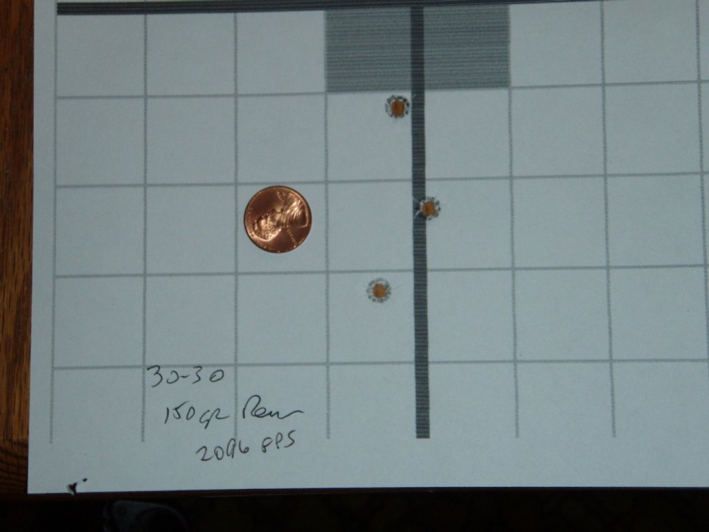

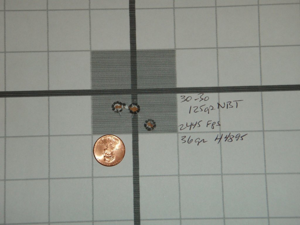

Had a good range day shooting the 30-30 SL and 357Max, the 30-30 doesn't particularly care for the 150gr Rem factory loads, velocity is very low also, I got 2330fps and excellent accuracy with the same box of ammo in my 30-30 Handi barrel that I sold to Mac, this barrel shoots it into about 2" at 2096fps.  :-\ Fortunately the 125gr Nosler BT and H4895 works very well in it, velocity isn't quite what I expected, but accuracy is excellent, a max load of 36gr from the Nosler 6th runs 2445fps.

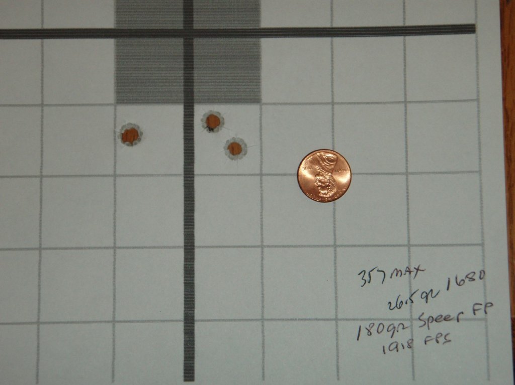

Also shot the 357Max using the 180gr Speer FP on AA1680, velocity was disappointing with the heavier loads and it may be because of the shallow seating depth with ~.200" of the bullet seated, best accuracy was with 26.5gr at 1918fps, I loaded up to 28gr, but velocity still averaged less that 2000fps. Guess I'll seat them deeper and try again, these loads were seated .010" off the lands.

  That 30-30 is looking pretty good. The 260 is a great round. I bet you will find a good load for yours.

100yds, I never shoot any closer except to get on paper after bore sighting.  ;)

Looking at that 357 max target, that's pretty good accuracy. I've only bene able to shoot mine at 50 yards, and with lighter bullets.  If I can achieve accuracy similar to your at 100 yards, I can live with 1900 of so fps.
Gonna track down some 1680 and some heavier bullets, find a longer shooting range and see what she'll do.

Tim, if I get a .357 max at some point I think I would try the Rem core loc 180 rn that work so well in my 35 rem Marlin.  The Marlin has a short barrel and only gets them up to 1900 fps but they just hammer anything they hit!  Since they are a bullet designed to work well at low velocities, it would definately be one I would want to try.  Just an alternate thought.  Nothing like throwing another variable into the mix!  44 Man

The 180gr Speer is a pretty tough bullet, it works well in the 35 Rem at 2350fps, I think I just need more powder, or seat it deeper, the 25-26.5gr loads were well smoked on the outside which indicates to me relatively low pressure loads, even the 28gr loads were smoked some.  I think CW gets 2200fps with it and 1680 in his Maxi, I don't really need it to hunt with, I just like to get the best performance I can with any Handi I'm shooting. The more I think about it, since it's accurate at that seating depth, I think I'll just keep working up in ½gr increments and see how it goes. ;)

Looking good Tim. For some reason, the highest velocity does not always get you the best accuracy. That maybe the best you can do with the 260. More experimentation will tell you. The 357 Max may do better at higher velocities, but not bad the way it is. For deer or coyotes your load in the 30-30 will work with plenty of accuracy. That light weight 30-30 would make and excellent walk around gun or a truck/trunk gun for opportunistic shots. Thanks for the report. Good Shooting and Good Luck.

The 30-30 will work fine just like it is with the 125gr NBTs and I'll use it when I hunt the wet side where most shots will be much closer, the 260 on the east side where it's more open. I'm also going to try BL-C2, Hodgdon shows it producing close to 2500fps at 3kpsi less pressure than H4895, a more friendly pressure for the M158 soldered underlug.

Were you crimping the max loads?

As best I could with the Lee FCD that came with the deluxe 357Mag die set, it's not the same as a rifle FCD, but it will put a light crimp on the Max. I also checked the loaded rounds for runout before and after I crimped them(new Hornady tool  ;D), the FCD reduced runout on all rounds by .001"-.002", all were less than .003" after crimping.
