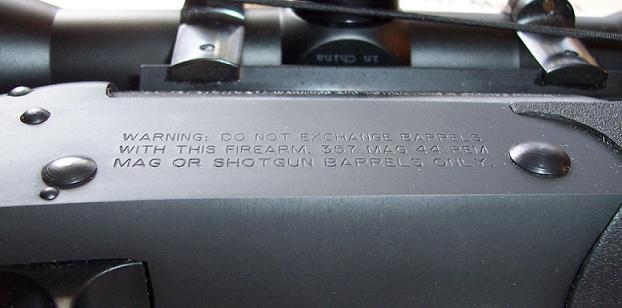

SB1. Only shotgun and 44 and 357 mag barrels can be fitted to this frame by H&R due to pressure restrictions.

This is from my H&R 1871 - Model SB1-S35 - .357 Magnum/Synthetic - Serial CAC 114XXX
