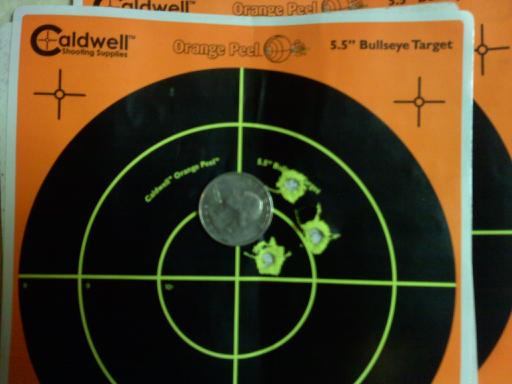

« Reply #14 on: February 14, 2010, 03:50:25 PM »
I had a chance to test some 36 grain varmint grenades in my .223 handi rifle.  It's nothin to write home about, but good enough to shoot at the occasional coyote.
