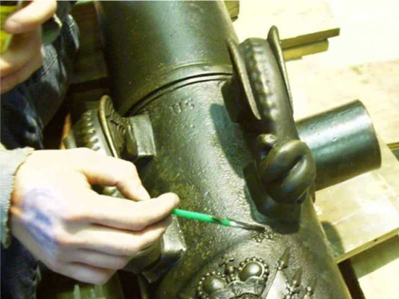

This outfit is named "Conservation Solutions Incorporated," and you can see when looking over the site that they do conservation work on some interesting and varied artifacts.
In the left hand column you can click on four different cannon conservation projects they were involved with, and three of those are on artillery pieces that are of pre 1899 manufacture.
What first grabbed my attention was the highly polished state of the Dahlgren boat howitzer shown in one of the photos (Carlisle Barracks Civil War Cannons). At first I thought it unusual that a reputable conservation company would polish a bronze artifact like that, but after reading the text it’s pretty clear that the Army was responsible for the highly polished condition of the cannon, and this company only “re-polished,” and then applied a protective clear coat to the barrel.
The “Washington Crossing State Park Cannons” article is about the work done on two bronze cannons captured by George Washington’s troops in 1776 at the battle of Trenton. One is of French origin, which I’ve seen many examples of, but the other cannon (I’m guessing) is Prussian, and it’s dated 1745. I’m also guessing that the F in the crest stands for Frederick the II, (Frederick the Great) King of Prussia from 1740 to 1786. If you recall our history, General Washington, along with Continental Army troops crossed the Delaware, and captured a whole slew of Hessians (Prussians/Germans) that were allied with the English forces. CSI

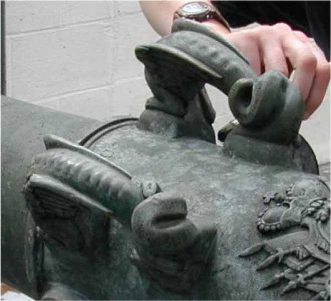

The Prussian 1745 cannon looks to be a well made piece of bronze artillery, but the one thing that I couldn't figure out is why there were no heads on the dolphins. They have such a wealth of details, like the coiled tails, the indentations along the spines, the wings, and the leg and paw on the side towards the center of the gun, that it didn't make sense that they were headless. After enlarging the photos as much as possible I could see (I think) that there were heads after all. I think that the ouside of the handle (2nd photo) shows the neck of the creature coming down along the side then curving forward showing a serpent's head with an eye and mouth (maybe).
