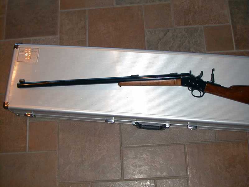

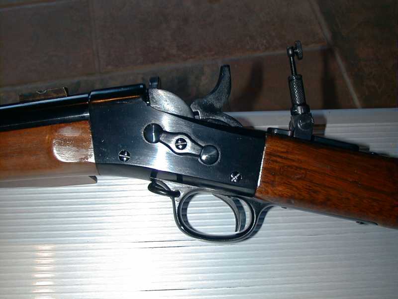

Rifle came in this wee, nice Christmas present.  Dave reblued the action.  The 30" barrel is heavy, tapering from 1 1/4 down to 1 inch at the muzzle.  I got a globe front sight and a tang sight, and since I am not too confident of my shooting I got the blocks installed in case I decide to put a scope on it.  I went out and shot it, and the groups were not too great, two or three inches at a hundred, but with iron sights and on the first reloads, I am happy with that.  Also, my bullet casting abilities are less than perfect.  I tried two loads with 400 gr bullets, one with 4227 and one with Trailboss.  As nice as trailboss is in the 45-70, it was disappointing in the 40-65.  I will go out and try different loads this week end.
Edit:  I just got hell from my wife for posting the pictures.  She says the gun is ugly because the stocks do not match.  That sounds like I have my excuse to get a butstock.

Nice rifle.  Try some loads with Accurate Arms 5744 powder.  Start at around 22 to 25 gr and a 400 gr bullet.

Very nice rifle you got there. I have a nice Uberti 1885 High Wall in .40-65. Really enjoy the caliber. Brass is easy to make out of .45-70. Use a sizing wax for your case forming to avoid oil dents then trim the case. They will be longer than max length after forming.

when you get yer new buttstock, how much ya want for the old one? just askin', bubba.

There is a reason I  do not show the whole buttstock.  It looks like it was cut, then a piece was glued on, then a recoil pad added.  It is butt ugly.  It may be a while till I get around to getting a decent buttstock and installing it, but if and when I get to it, you can have the old stock.
