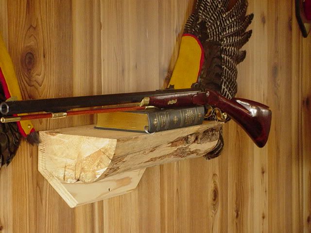

here is a bobcat dressed for the ball . alot can be done with these little rifles . most shoot also very well

Captchee, that is one good looking gun.  I was out this morning with my Bobcat, the day being rainy and I did not want to take out my flintlock.  It was perfect for a day like today.  Unfortunately, the weather has warmed up enough to slow down the rut, so I did not get anything.  I bought my rifle at Walmart since it was only $49 and I wanted a plinker and knockaround gun.  It fills the bill quite well.  When the rain got heavy, I went to a gunshop that I had not visited in a while and found out how out of touch I am. I was looking for round balls, and they looked at me like I was one of those cavemen in the Geico commercials.  No telling what they would have done if I had requested Kentish flints.
Captchee, I was looking over this old post and I came across that beautiful dressed up Bobcat you customized.  You have inspired me to do something like that to my rifle.  So, if you don’t mined, can you tell me were got the stock and brass hardware?
Offline captchee
  • Posts: 432
Re: Bobcat?
« Reply #15 on: December 15, 2006, 10:33:30 AM »
sure no problem .
 the stock is  a fusil de chase  taken down considerably and  was purchased from pecatonica river
 The but plate is also from a fusil de chase .
 Trigger guard  and nose cap  are brass   styled after a late hawkens  half stock rifles .
 All the brass I go t got  track of the wolf  or made myself .
 I kept the original trigger set and just cut off the guard. rear sight is original . Front is a brass blade
 Ramrod thimbles are  brass golden age  era , octagon with ring bands .
 I did not use the standard entry thimble  for this set . Instead I placed one of the 5/16 thimbles into the  3/8  ramrod hole for the stock  . The Tulle has a good size ramrod and this  reduced the size  of the entry so that the own could use a standard 5/16 RR.
 Now the front  RR barrel is tricky  as you have to keep the separation from the barrel as the bob cat does not have an under rib . For this I cut off the plastic  , stock barrel being careful to  save the  mount section .  I then screwed the new brass RR barrel to the plastic mount . This way  you can use the stock mounting hardware
 If you want parts numbers I  will have to look them up , they will be in my records for that rifle so that’s not a problem
 here are some  shots of  the bobcat at diffrent angles

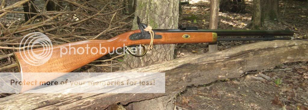

Here's my Bobcat (aka "The Mutant")
With the exception of the trigger assembly, everything was purchased from Deer Creek Products.
