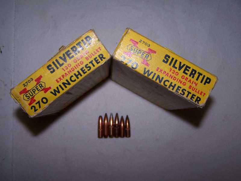

The SilverTip bullets remind me of the SilverTip bullets for the handguns that have an alluminum jacket, but it looks like an alluminum tip in front of a copper jacketed pullet. It is not lead or a lead tip.  I can't scratch it with my thumb nail but my knife scratches is without a problem, it appears to be alluminum.  I do not beleive they are the newer Combined Technology bullets as I have had these about 14 years and they had been sitting around before the guy sold them to me.  I think the Combined Technology Winchester/Nosler bullets are only about 6 or 8 years old.
Here is a photo, not the greatest as my camera doesn't work good for close ups, but it shows what I have.
I think shot1 may be close in that they are similar to the Bronze Points, but I am seeing that the Bronze Points expand rapidly on impact and what little I could find on the SilverTips is that they go thru and thru and leave a little hole on the far side as if they didn't expand if they didn't hit a large bone.  But I don't know what that source is and do not really trust it.

Those are the original WW Silvertips with a protective sleeve which goes a fair way down into the bullet. They are not near as explosive as the Power Points, Bronze Points or Ballistic Tips.
For elk I would go 150 gr or heaviest for cal available controlled  expansion design.

OK, while sorting through some things in the garage I located 10 boxes (20 rounds boxes) of reloads.  I aquired these from someone and they were loaded up by an old hunter who has passed on to the Happy Hunting Grounds.  Surprisingly 4 boxes were loaded with Bronze Points and 2 boxes were loaded with the old SilverTips.  Soooooo .....
Having a renewed interest in both I selected one of each and introduced them to the disc sander with 150 grit paper so I could get a look at their construction.  The Bronze Points resemble the Nosler Balistic Tip, as mentioned by someone earlier, and the bronze tip is inside the front portion of the lead to drive it open on impact.  The Silver tip, as mentioned earlier, had the alluminum cone over the nose but the cone continues inside the copper jacket about half way down the bullet.  The bullet is filled with lead but the alluminum jacket surrounds the front half and the copper jacket surrounds the bottom two-thirds and the bottom three-quarters of the alluminum.  It appears the alluminum will hold the front portion together to limit expansion unless it hits something solid, perhaps like a shoulder bone, at which time it will be pushed further inside the copper jacket and may cause the copper jacket to begin to mushroom.
I will try to find a camera that will allow a clear close up photo so I can post it for all to see.  I will also try to locate one of the many Nosler Ballistic Tips I picked up from NRA shows I have attended over the years.  If located I will open one of them up for comparison, as well as one of the Game King bullets.

Admittedly I have been a fan of the .270 Winchester since I could read Outdoor Life magazine, which came a few years before the State would sell me deer tags.  My favorite writer was Jack O’Connor who wrote about the .270 Winchester than any other outdoor writer.  He did write about other bullets but the 130-grain Silvertip appeared to be his bullet of choice on many a North American hunt.  He did write that he prefer the 150-grain Nosler PT for elk.
I rather suspect you are an old .270 Winchester user, and you might have the following publications.  If you do not I suggest you might want to check your local library.
The Art of Hunting Big Game in North America, Library of Congress number: 67-14558
The Hunting Rifle, Library of Congress number:  72-99749
Jack O’Connor wrote other books but those are the two in my library.
Rumor was that late generation old style aluminum Silvertip had a redesigned jacket that was more explosive than earlier generations.  A few years before they discontinued the aluminum tip Silvertip I believe WW came out with a 165-grain Silvertip with a boattail in .308 diameter, and I know they came out with a 140-grain boattail Silvertip.  According to one writer the bullet showed good accuracy and weight retention.
In two of my 270 Winchester rifles the 140-grain (old) Silvertip produces outstand accuracy.  There is no variation of weight when I weight the bullets on my scale, 140-grains.  If they perform as good on game as they do on paper it would become the Go To bullet in one of my rifles.
I got digging around and found evidence that I shot up a couple boxes of 130-grain Silvertips many years ago.  That was a period of time I used the 270 Winchester for just about everything except ducks.
Here are a few bullets I have loaded.  These were near the top in my loading gear, there are other stored away.
L to R.  150-grain Remington C-L, I50-grain Sierra BT, 140-grain Silvertip, 140-grain Hornady BT, 130-grain Hornady SP, and 130-grain Remington Bronze P.T.

Their is a faint echo in my fading memory that the very first Silver Tips used a
cupro- nickel "nose cone", the aluminum came later. Any other OF here shares that memory??   I could be wrong, it wouldn't be the first time ??? ::)

i have used silver tips in the 30.06 the 300H&H on elk muley and 1 time with the 300H&H on Black Bear. Very poor performance  in all cases. all animals were shot inside 100 yards the bullets blew up basicly. after i questioned winchester by mail and other long time hunters i found out that the speeds of impact at those ranges were too fast and the bullet just could not take it. had the ranges been out 200-250 yards the bullet more than likely would have performed perfectly as the speeds would have fallen to a more optimum ipact velocity.
needless to say i have never used them again. i use nothing but nosler partitions on all big game. there are many out there such as the fail safe that will do very well. bullet construction that will permit the bullet to perform at close ranges as well as distance are a must with very fast bullets.
