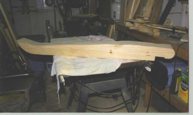

My half scale barrel will arrive this week!  The stock is cut, and I will cut the cheeks after the barrel arrives.  I will be buying 30" wheels.  I'm not sure if I should get wheels with bushings or not.  It seems that most of the places that sell wheels say you can use black pipe for the axle, I don't think that is the best idea.
Should I get wheels with bushings?
What should I use for the axle? (My plans call for the axle tree to be 2.25" square)
How should the axle tree be attached to the stock and cheeks?  There is no indication in the plans I have.

First of all, what plans do you have?  They should clearly show how the stock sits on the axle tree.
The stock is notched to fit over the axle housing as are the cheeks.  The axle housing will be held to the bottom of the cheeks with iron straps.  The cheeks will also be wrapped with iron straps which overlap the axle housing straps in the front.  The trunnion cap bolts will run vertically through the cheeks and through holes in the iron straps.  This will strongly tie everything together.
I would use a 1" round iron bar for an axle but this decision must be based on what your wheel hubs are.  Personally, I don't think bushings or bearings are necessary, though they certainly will make the wheels roll more easily.  But for the most part, you are not likely to be rolling the carriage for any sustained distance.

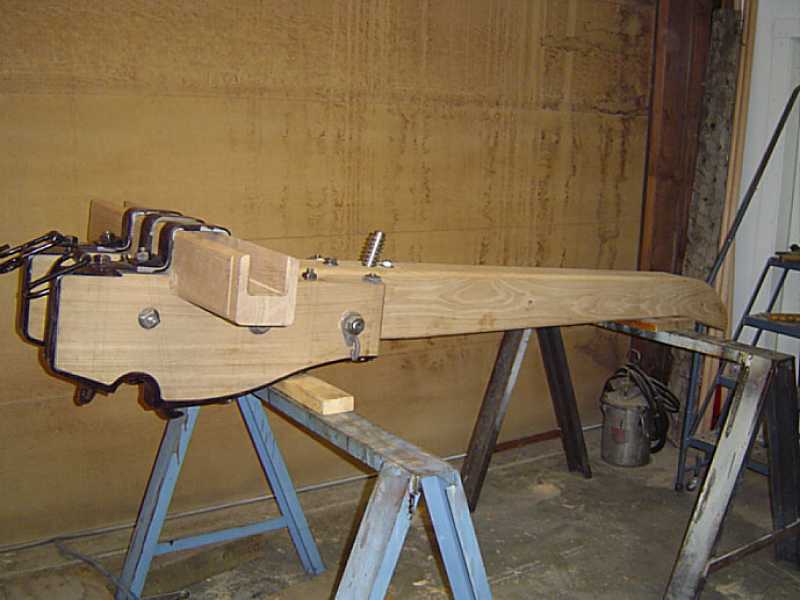

Notice the notch that goes over the axle housing in this roughed out trail.
This is a split trail carriage but the theory is the same.  Notice how the iron straps on the cheeks overlap the straps on the axle housing.  A bolt runs vertically through the cheek to secure these straps.  The top of the bolt is modified (flattened and cut for a trunnion key) so it won't pull through the straps.
Hard to tell in this picture but you can see the trunnion keys inserted into the "flattened" end of the vertical bolts.

Thanks for the input guys.  The plans I am using came from Jerry Clement for the 1/4 scale Parrott.  The wheels I was looking at require 7/8" axle IIRC.   The plans show the iron wrapping around the cheeks and the axle tree, but I wasn't sure if that was all there is to it.  The front of the stock will be notched as will the cheeks.  If the iron wraps around the cheeks and axle tree it will fasten the cheeks to the axle, but what holds the stock to the axle tree?

These are the plans that I have.  The finished gun is one quarter scale according to the plans.  I have doubled all the dimensions for my carriage.  I see the piece on the plans now for the axle strap.  I didn't quite understand all the metal pieces on the plans.  I have already talked to Dom about making the cheek straps and trunnion caps.  I guess I'll have to add to the list of materials I need from him.  :)  (Are you listening Dom?  :))
