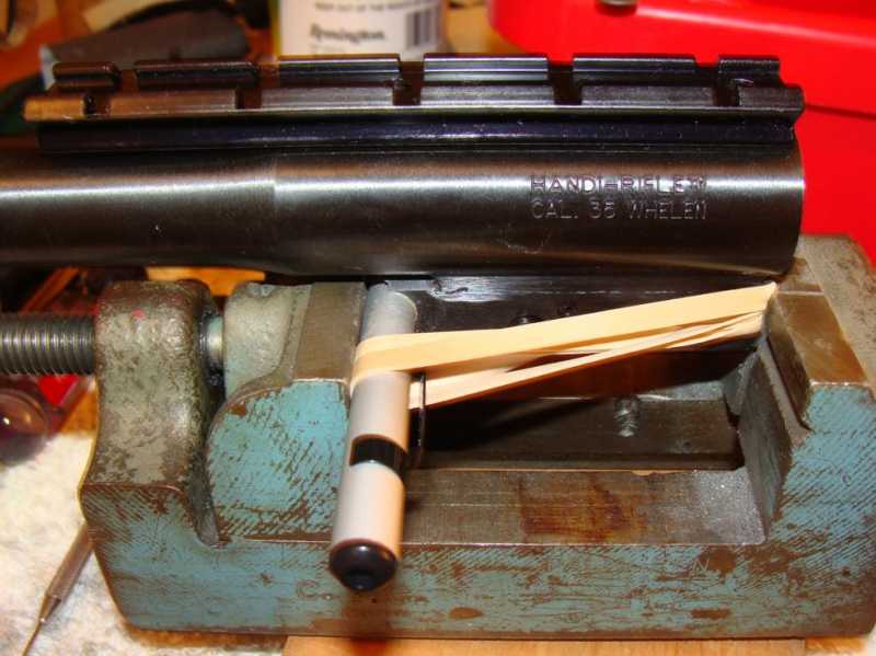

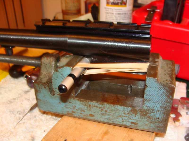

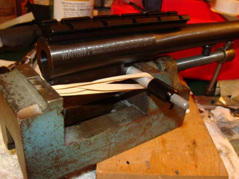

Hello fellow Handiaholics,
  If it may be of assistance to someone, I have posted a few pics of the "jig" I assembled to allow a newly epoxied barrel shim to set. I'm using a Gerber knife sharpener to seat against the shim because it has a perfect fit inside the channel. I'm gonna let it sit overnight and tomorrow I hope to have a permanently fitted .35 Whelen barrel. This time I used a brass shim that is .006" thick, it should hold up a little better than the aluminum can I had used before. The rubber bands were placed to hold the sharpener in place while I cinched it into the vise. They could be removed/cut now. I also placed a plastic flat waher on the chamber end to prevent any galling of the metals. Let me know whatcha think. Could I do something better/easier?
Thanks, Dinny

I like it. Did you rough up the back side of the shim and the hinge face to hold the epoxy? How much pressure do you apply - I mean does all the epoxy ooze out? Would one of the so called "super" glues work for this application, since you can polish the surfaces and it wants zero clearance? Why wouldn't you use a stainless steel shim, it should last the life time of the barrel. I really do like the concept, it is the best one I have seen so far. It makes me think about fitting a barrel for the first time.

LaOtto,
  I did rough-up the mating surfaces with some medium grit sandpaper. I screwed down the vise until I noticed that the shim was perfectly positioned all the way around. Some of the epoxy did ooze out and I scraped it away before it hardened. Tim has listed a few different epoxies to use, I couldn't find any of them so I used Elmer's Glue. ;D No, really I used a permatex epoxy made specifically for metals to include brass. I had first measured everything and prepared a shim from a set of feeler gauges. I found that the blade was difficult to bend into place so I decided to use brass instead.
Good luck.
-Dinny
