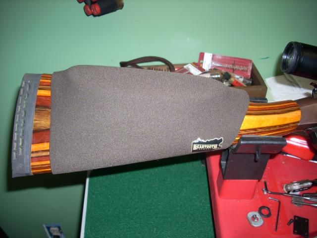

Here is a pic of the straight comb stock I have the beartooth on... It works well enough. I'm sure no better then what Mac has posted.
CW
