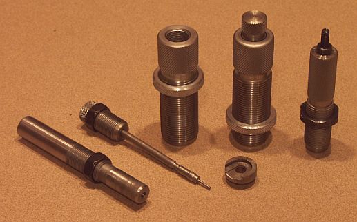

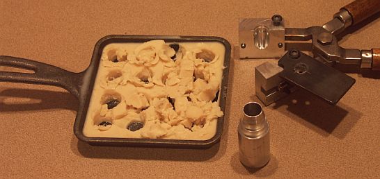

The mold is from NEI Handtools Inc (Scappoose Oregan 503/543-6776). It is a shortened version of their mold for a 900-grain bullet for the .600 Nitro Express. The dies are from CH Tool & Die Company (Mt. Vernon Ohio 740/397-7214). They are custom made and one needs a press large enough for the .50 BMG to use them. Also, I got the mold and dies 6 years ago so don't know if the telephone numbers and addresses are still current.
RocKy Mountain Cartridge (Cody Wyoming 307/587-9693) made the cases to precisely fit the chamber of my gun based on a chamber cast I sent. CH Tool & Die got both the chamber cast and a couple cases for custom making the dies. Note that the cases have very thick brass where the bullet is. They are not like the brass cases for loading bird shot.
The cases fit the bullet and chamber so well that after the first loading I have never had to resize a case. That is, the neck area of the case springs out to release the bullet when fired, but springs back to its original diameter afterwards so that the next bullet is held into place. I understand the cases bench rest shooters use do the same thing.

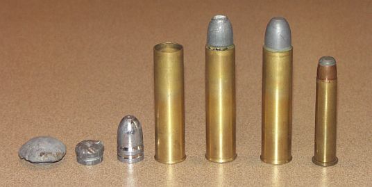

The 720-grain bullets are 1.03-inch long. I cast them out of pure lead and at 1,000 fps I think there was no expansion at all on the deer I shot. At least the entrance and exit hole appeared the same size.
The deer shot with the 550-grain holow point was facing me at a very close range. The slug hit it in the chest and went through some of the spine and ended up just back of the diaphram. The second photo shows two shot slugs.
The first is a 720-grain recovered from dirt behind a paper target. The second is the 550-grain slug recovered from the deer. Note that all the lead around the hollow point is missing. These slugs were made from a harder alloy. I think pure lead would have mushroomed instead of fragmented.
The pure lead slugs do not lead up the barrel. The harder alloy 550-grain hollow point slugs seem to lead the barrel a little. I think the lead was too hard for the pressure and that they did not obturate to seal the barrel. I use a very soft lubricant.
I think either a hollow point or a slug with a very large flat on front would be a lot better than the round nose slugs. At least that is my experience with air rifle pellets. The pointed ones do not have nearly the killing power of the flat nosed ones. Also, I suspect that even with a flat nose or hollow point penetration will be good. That 550-grain hollow point slug failed to penetrate the deer lengthwise, but it lost a lot of weight. I just weighed it and its remaining weight is about 310 grains. If it had retained more weight I bet it would have penetrated a lot farther.
