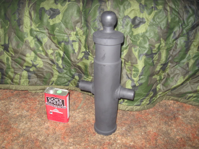

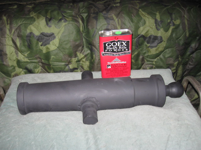

Due to recent inquiries I thought I would try a mountian howitzer , this is my first attempt .
This is Golf Ball bore , but due to the size and weight I think I should have gone to a 2.25 bore .
Comments, suggestions ? Armorer77

« Reply #1 on: October 24, 2009, 06:34:09 AM »
Looks pretty good to me. 2.25 bore would be even better. Better trajectory with something other than golfballz.
What is the length and weight?

« Reply #2 on: October 24, 2009, 06:41:13 AM »
Good point , The LOA is 18" , weight is 42 lbs. Bbl. length is 12" chamber is 1"x3" Trunnions are 1.5 dia. x 1.75 long . Armorer77

« Reply #6 on: October 24, 2009, 08:15:33 AM »
I like it, Armorer77! I'd also vote for the 2¼'' bore size; when you say barrel length 12'', are you referring to the bore depth?

« Reply #7 on: October 24, 2009, 08:17:59 AM »
Yes , 12" is the ball sized bore . Armorer77

« Reply #9 on: October 24, 2009, 08:09:41 PM »
Good and beefy looking Mt. Howtizer, real nice! Should be a pretty good shooter, sturdy so no problem with whatever load you feed it! Haven't checked the classifieds yet, I'll wait to see what you will be asking for the 2.25"er....BoomLover

« Reply #12 on: October 25, 2009, 01:18:55 AM »
armorer77,
Your howitzer is looking good, the cascabel knob looks a little large in proportion, observation not criticism,

« Reply #13 on: October 25, 2009, 04:12:06 AM »
Cascable knob is enlarged in the first pic due to distortion caused by it being the closest object to the focal point of the camera, IMHO...second shot shows it to be in perspective, I belive...what say you, Armorer77?

« Reply #15 on: October 25, 2009, 06:50:52 AM »
For a 1/2 scale mountain howitzer, the cascable diameter should be 1.35" and the neck should be .8".  The widths of the breech and muzzle bands are .5".
If you don't have one, you should get one of the No. 25, No. 67 or No.68 plans folios from Antique Ordnance Publishers.  They have drawings from original plans.

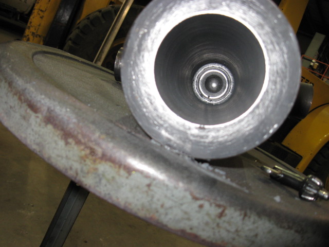

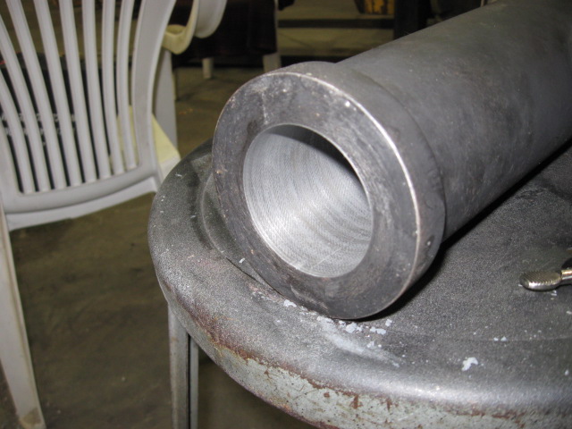

« Reply #22 on: November 02, 2009, 05:48:22 AM »
I got her bored up to 2.290 bore now . Had a problem with chatter to clean up but I think this will work . Armorer77
