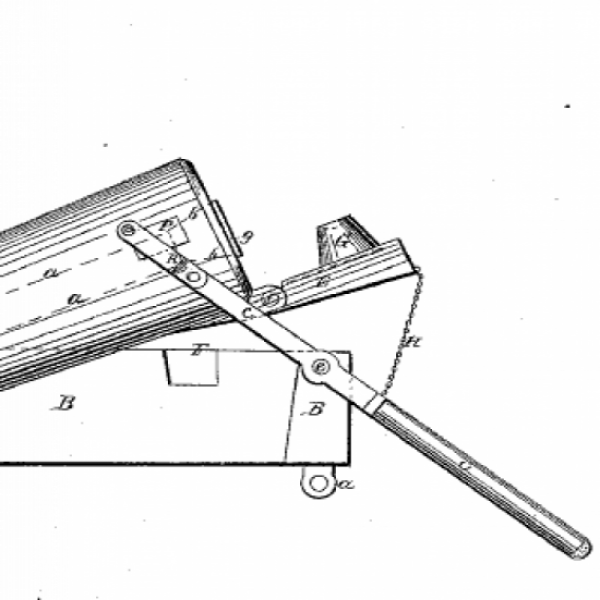

Here's one I just found.  Looks like the guy was ahead of his time-combustible cartridge with metallic base as a gas check.  That's what the 120MM Abrams tank gun uses now.
http://www.google.com/patents?id=giNeAAAAEBAJ&pg=PA1&dq=moffatt+cartridge&source=gbs_selected_pages&cad=1#v=onepage&q=moffatt%20cartridge&f=false

« Reply #47 on: September 14, 2009, 04:31:31 AM »
I asked because the patent drawing shows a primered fixed shell and the gun does not appear to have a striker mechanism to impact a primer.
If this gun uses a base plate shell it should fairly easy to to turn one out from brass or aluminum on the lathe.   The base plate shell could be fired with shotgun or 50 BMG primers.
