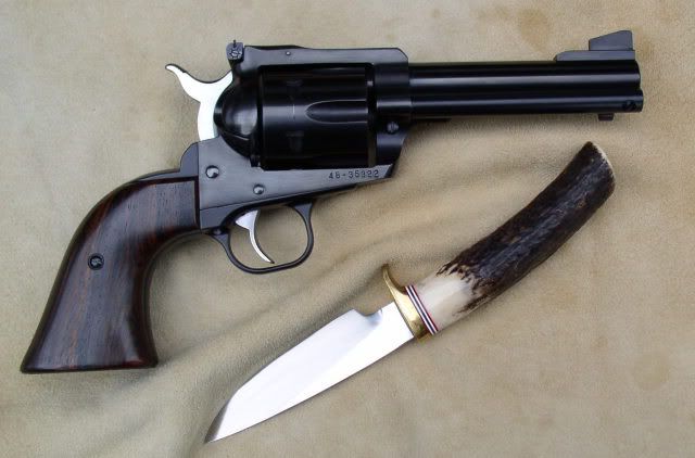

Leave the CR home and pack a BH on your hip instead!!
CW
CW, you mean somethin' like this...
"...a backbone is better than a wishbone..." Paul Thorn
CW
That combined with a good leather rig would be perfect!!!
I have never owned a short barreled 45 SA. Mine is a 7.5".
My "carry" SA is a first model Ruger BH .357mag with a 4 5/8 barrel, "silver frame" and stag grips. Shoots 180gr Black Talons into one hole at 25 yards!!!
