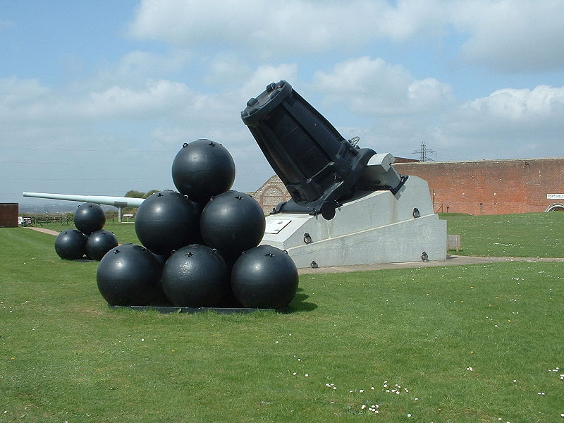

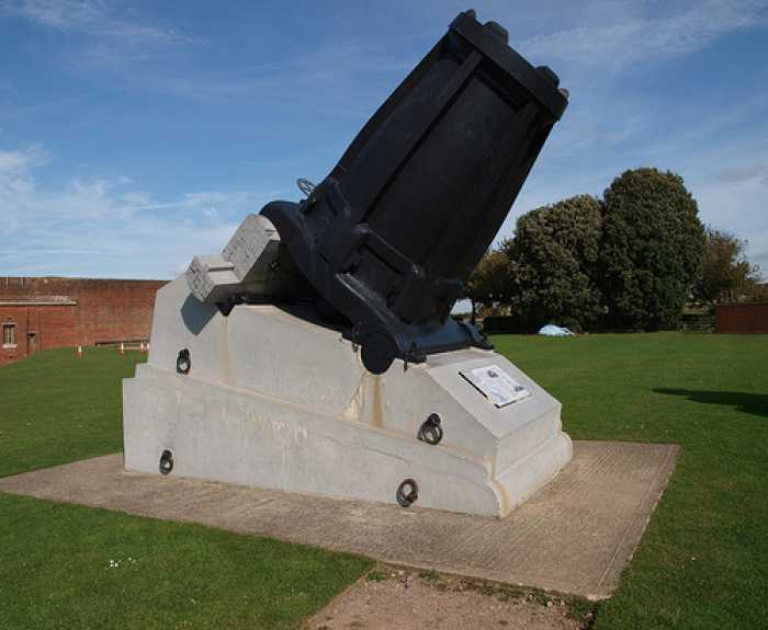

No one has yet to mention that the Robert Mallett who authored this British study of artillery constuction, materials, and failures of pieces in service, is the same Robert Mallett (great Irish scientist, engineer and inventor) who designed the ingenious, and famous huge mortar (which was popularly known as "Mallett's Great Mortar") that the British had intended to bombard Sebastopol with in the Crimean War. I'm sure that a lot of members will remember that Tracy and Mike built a fine miniature of this unique mortar.
Re: PRINCETON explosion report
« Reply #13 on: July 30, 2009, 10:10:11 AM »
One of Mallett's mortars, and the 36-inch shells that it was intended to fire, on display at Fort Nelson in England.
