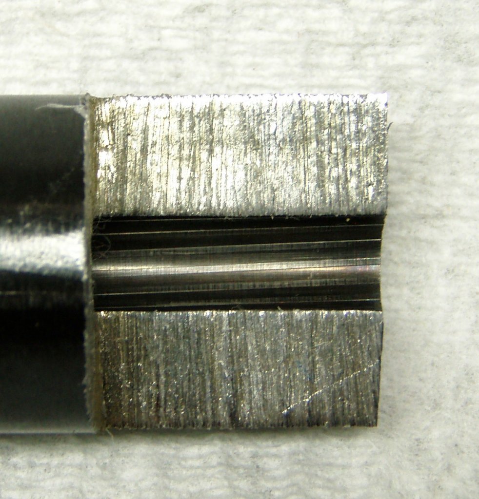

I agree with Larry, H&Rs have shallow rifling with wide lands, not micro-groove, the only micro-groove barrel we've seen is the 22Lr Versa Pack, pic below.
