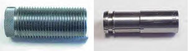

I'm not sure which crimping die you are using but if it's like the LEE Factory Crimp die that I have, the main body parts are like these pictured:
The mandrel, on the right, simply slides into the main body, on the left, and has no holding/locking device involved.
Hope that helps but I have a feeling this style of die is not the one you are using.

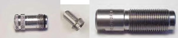

Sounds to me like he's using the standard seater to seat & crimp , if so the seater stem goes in from the top and has a rim to keep it from falling through the die body .

More like this bullet seater die (parts)?
Offline 45-70.gov
  • Posts: 7009
Re: HELP........SLUG STUCK IN DIE
« Reply #4 on: July 18, 2009, 03:20:57 PM »
this  is  it
i  beat  the  bottom  with  a wooden  dowel  hand  holding  it  upside down
thinking  the inertia  would pull  the  bullet
when  the  ''top punch''  came  out
then  it  was  simlpe  just to  drive out the  slug
thanks  for the  pictures  and rapid responce
i  had several  lee  dies  i  hadnt  used  yet  so  i dismanteled  them
  this  was  an  unsized  lead  slug  i was  fire lapping with
it  was  so  ocersized  it  was stuck ib  the crimp section
then  messed  up  the brass and  ended  up
flowing  into  the   top  punch  area
