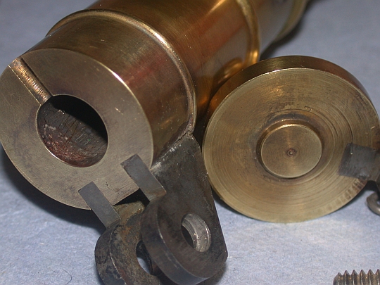

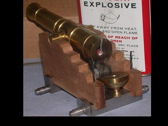

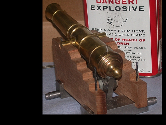

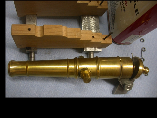

Unfortunately I let work interfere with my cannon building time and I did not get it done in time, however I thot I would post what I have as of the morning of the fourth.
It is a breechloader with a groove for the fuse. I put steel axels on it to keep the weight up, although I don't think recoil will be a problem.
The barrel:
Breech open to load:
Breech closed to fire:
Surely it will be done by next fourth :)

« Reply #102 on: July 12, 2009, 07:03:45 PM »
MikeRC , can I ask you what it's made of and how you made that barrel ?
Re: 2009 4th of July FIRECRACKER cannon Contest!
« Reply #103 on: July 13, 2009, 01:59:29 AM »
Oooooooooo !
Elegance!
I KNEW that SOMEONE would do one with style!

Offline MikeR C
  • Posts: 178
« Reply #108 on: July 13, 2009, 07:08:32 PM »

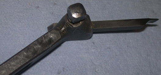

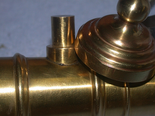

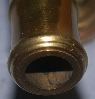

Cat,
The barrel is brass shafting, scrap, probably 360 but I don't actually know. I redrew one of the barrels off the CD that the navy sells of the constitution, and scaled it down. The taper was roughed out in steps then filed smooth in the lathe. The mouldings were cut freehand using a bit with a round, 1/64, radiused end. A bar is put in the lathe's tool holder and positioned close to the work then the cutting bit is rested on the bar, held in the hand, and the brass is cut freehand as you would do in a wood lathe with a gouge. The "Breech" was done the same way including the cascabel. As long as the rest stays close to the work, 1/8 to 1/32, it seems very safe.
The muzzle:
Moulding detail and breech:
The tool I used"
I milled two slots in the back of the barrel and silversoldered the hinge parts, then milled a slot in the breech and silversoldered the center hinge in. There will be a stop bolted to the rear axel that the hinge will close against when the barrel is down, then once it is fired it the barrel will tip up and the breech will open to reload.
Detail of the moulding:
« Reply #109 on: July 13, 2009, 07:11:11 PM »
My vote is for mikerc that is a nicley proportioned tube  ;D with a clever breech mechnisum.
