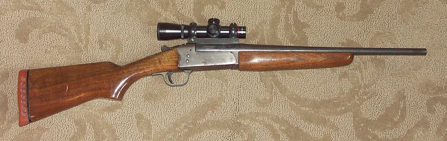

MATT - I was thinking about the same thing, but maybe even lining the whole barrel back to the chamber. I just bought this old Model 220B Savage in .410 and got a mount and scope (1.5X Simmons) on it. Yes it's legal with a 18.25-inch barrel. I have only got it bore sighted so far. It has not been tesed for accuracy but I think it would probably shoot better with a rifled bore. I used to shoot slugs out of the .410 barrel of a Stevens .22/.410 over/under and they were pretty accurate. - DON
