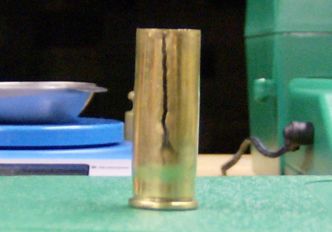

I found this pick a while back. This 44 mag was fired in a 444 marlin no by me though.

« Reply #6 on: June 06, 2009, 08:43:58 AM »
A picture is worth a thousand words.

I've always been told the only stupid question is the one you didn't ask. I figured
someone had tried it. From the looks of that picture I won't be . Thanks to all
for your input.
