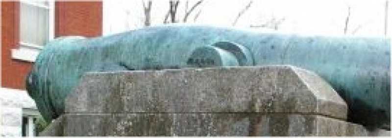

This Cyrus Alger & Co. M1838 6-pounder field gun is currently located on the lawn of the Gasconade County Courthouse, in the city of Hermann, Missouri.
Forgive the odd syntax of this article; I copied it from a website about Hermann, MO, and it was written by a reporter for The Advertiser-Courier on the 9th of October, 1907.
"On the afternoon of October 4th, 1864, the advance of Gen. Marmaduke's army in their march westward made its appearance on the hills on the east side of town. The town which maintained a militia company composed of infantry and also a section of artillery had received before the war from Gov. Stewart a cannon, and this on the arrival of Gen. Marmaduke's army a handful of desperate citizens picked up and from the railroad track at the high school fired at the intruders who were coming around what is now called Frank's Bluff. Our gunners in a jiffy pulled their cannon on the hill where the Catholic church stands and fired at the Confederates on the opposite hill, from here they went into the wineyards of the new Stone Hill Wine Co., and kept up the shooting till their ammunition gave out. The Confederates figured that all of the western hills in town were fortified with artillery and checked their advance for an hour or more. The gun had in the meantime been spiked and thrown in the river.... The cannon was later fished out of the river by some soldiers and taken to Jefferson City, but again restored to the town by Gov. Gamble.
For the celebration commemorating the 50th anniversary of Hermann's founding, the cannon was to be fired 50 times. However, on the 48th firing, the barrel burst irreparably."
It's a shame that the townspeople celebrating Hermann's 50th anniversary didn't do a little more research on bronze cannons, because if they had, they might have learned that quickly firing a number of successive shots in a bronze gun could cause it to overheat; even to the extent that the barrel might be "irreparably" damaged.

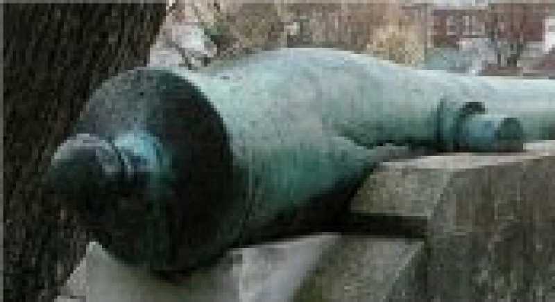

I enlarged and cropped the photos.

i'm not familar w/an 1838 cannon , so i'll ask if the trunions were below center . if they are/were then it looks upside down....?
did they have to beat the pieces in to fit the mount ? was the cement mount now the same one as when it burst ?
looks like it melted as the relationship between the bore and muzzle ends are so misalgined .

It looks to me that the poor thing got hot tha t breech just slumped.It looks much lower than the true line of the barrel and there is a sign of the extra roll of metal at the rear of the trunnions.

Rocklock, the Model 1838, bronze 6-pouder field gun had its tunnions located on the centerline of the bore. I think the gun is mounted right side up, it may appear the way you describe because the breech of the tube is "drooping."
I'm guessing that when the townsfolk were firing their anniversary salutes that this gun was mounted on a carriage, and sometime after it was damaged they had it mounted on the display base that is shown in the photos.
