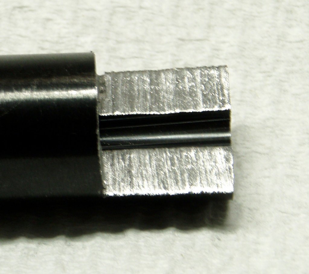

  • Posts: 43310
Re: rusting!
« Reply #10 on: April 22, 2009, 08:18:09 AM »
I think the problem with Handi bluing is they don't spend a lot of time neutralizing them after they're blued, every Handi I've ever bought has turned patches brown for a while when cleaning them right out of the box, if you don't clean them good to begin with and use a good rust preventative from the get go, you may have problems, that's one good reason why cleaning them good right away is essential, bores are blued too in case anyone wasn't aware, so cleaning inside as well as outside is a good practice.   ;)

Haven't had to much problem with rust on the frames but the finish on some of the barrels is a real joke.
I have one barrel that even looks silver in color the blueing is so thin.
Just taking it out on a damp day will cause it to start to rust.
I just keep plenty of Break Free around, in the house, my shop, the hunting cabin, and my range bag.
Now some of the older barrels had a right nice finish on them.
It is not hard to tell the difference.
Just run your hand over the surface.
If it feels like fine sand paper well guess what!
I always clean a new barrel but didn't realise that they were blued inside to.
Most of them would give brown/rusty patches untill clean and then they looked just like any other barrel.
I guess that will tell you just how thin there blue jobs can be.

  • Posts: 43310
Re: rusting!
« Reply #13 on: April 22, 2009, 12:12:22 PM »
Here's a piece of sectioned Versa Pack barrel.

 As always a wealth of handi knowledge you are ... I would not have guessed them to be blueing the bores of the barrels  that might explain a few problems there with accuracy ( wont dive into that at the moment )
