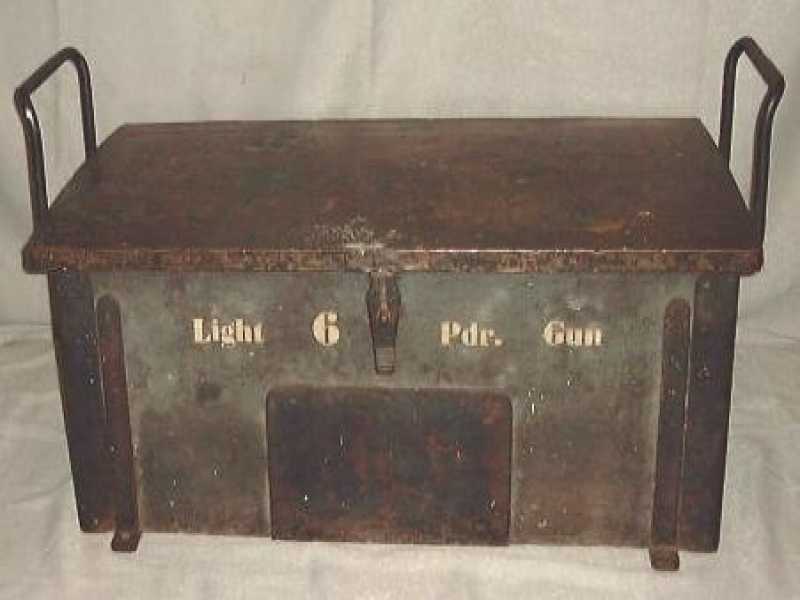

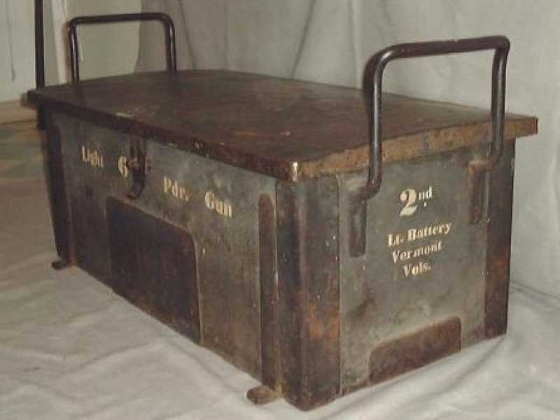

Michael, here are a couple photos of an original, and some pics of a reproduction that were posted on the N-SSA forum. Other than the copper lid cover, the hardware was made of forged iron.
http://n-ssa.org/phpbb/viewtopic.php?t=9106
