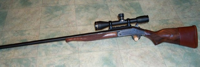

Also have one of these with the same complaint. The stocks from any other will fit. I am going to get a rear stock from the H&R Trap and change the pad on it. The wood on this model appears to be a good match to the B.C.

I purchised a lace-up recoil pad from Cabelas,fit was good and looks were no bad,I did not think any other pads would fit the BC.

I think the stock off of the Topper Deluxe Classic is a good substitution. It is walnut, checkered and a good match for the forearm.  It has a recoil pad.

Another option would be to cut and fit a grind to fit recoil pad on it.

You can do several things as has been mentioned, I've done them all except the trap gun stock.
small Galco slip-on
TDC stock set
TDC butt w/BC forend
TDC forend w/BC butt and Limbsaver

45 total, that includes two BCs and two Targets. TDC = Topper Deluxe Classic, not all of the checkered walnut stocks are as nice as that one, I have one on my 44mag that is very plain in comparison, small grind-to-fit Limbsaver.

I like the checkered fluted-comb select American Walnut Co trap stock on the newer Topper Trap Gun (TTG).

The old email address is no longer valid for Ilion or Madison, you have to call them, phone number is the same, (866)776-9292 toll free. The Topper Trap butt is part #S04116 $58.70, forend is #S04117 $32.85.  ;)
