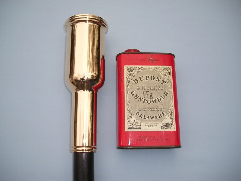

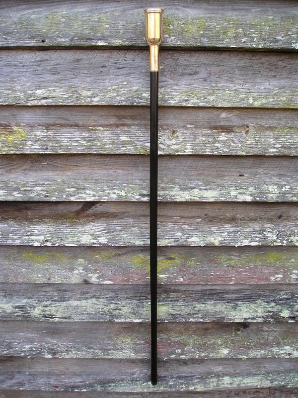

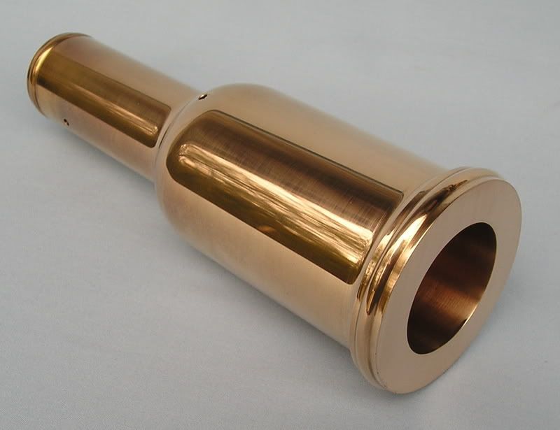

I have thought that a gonne would be a lot of fun to shoot so I decided to make one. I made a pattern, cast it in bronze, and finished it on the lathe. The barrel weighs 6 pounds and has a golf ball size bore two calibers deep. The staff is ash and the total length is 61 inches.

Thats pretty!  The barrel reminds me of an early grenade launcher.

Dom, I agree that it looks like an early grenade launcher, maybe that's where I got the design.

Had a question, Max...what is the size of the powder chamber in this beautiful  handgonne? Also, what is the depth and diameter of the tiller socket? Again, great job! Thanks, BoomLver

BoomLover, The powder chamber is .625 X 1.25 which should be about right but I can make it larger if needed. The staff socket is 1.10 X 2.25.
Terry C, Thanks. I'm looking forward to shooting it. I like the idea of standing up and loading it like a musket. Should be a lot like shooting my Brown Bess but with larger balls, a bit more recoil, and a much shorter ramrod.
