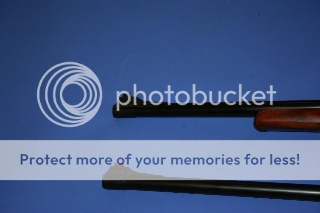

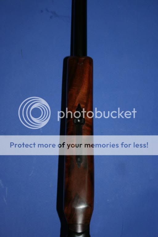

   Some time back a customer of our shop stoped by and asked if I would build him a custom rifle based on a Handy rifle.    After talking it over I took the job.    He wanted a Claro stock with checkered steel butt plate and skeliton grip cap. Four barrels chambered in 45-70, 38-55, 7mm08, and 30-30.
   I turned down the 7mm08 and 30-30 barrels to a light sporter contour, the 45-70 and 38-55 barrels were given banded front sights since I used a steel trigger guard I made up steel forearm spacers for the two forearms.    I checkered the skeleton grip cap in 28LPI and the stock and forearm with 22LPI.    The forearms are held on the rifle with Deeley latches.   I will to try to post s few pictures of this rifle, hope you enjoy them.
This picture is of the Deeley latch on the forearm, At this point I had not checkered it yet.

I forgot to post this one.   This is the two barrels with the banded front sight.
