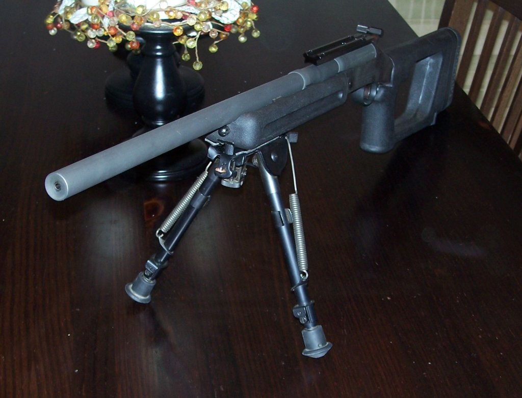

Or you can have one stubbed and get a 17 FB with a Twist rate of 1 in 9" with a bull barrel made of 4140 carbon steel.  ;D
