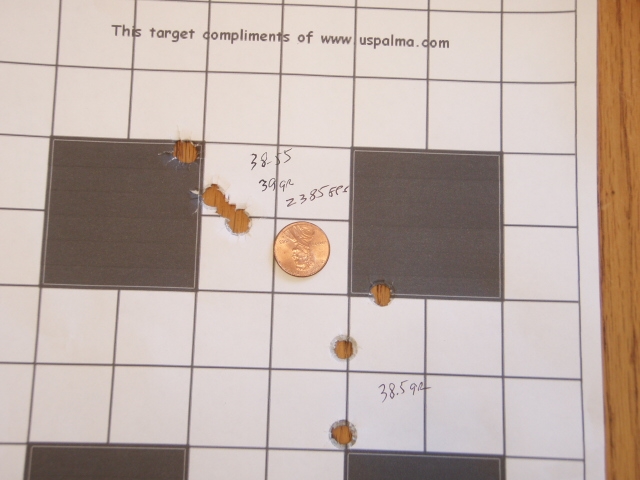

« Reply #3 on: January 09, 2009, 10:09:28 AM »
Yes in Starline long brass using Lyman 48th data, 220gr JSP @ 2385fps.
The SAAMI MAP for the 375 Win is 52kcup or about 60kpsi which is ~64kpsi CIP as Fred said, well within the Handi capabilities with a smaller case head than the 270Win which has a SAAMI MAP of 65kpsi.
I'm not advocating 375 Win level loads in just any 38-55, that would be foolish, but the 38-55 Target uses the same SB2 frame and 4140 alloy barrel of the high pressure chamberings available from H&R like the 270Win, 30-06 and 500 S&W. Just be sure that any ammo you load in the 38-55 brass doesn't get in any other 38-55 firearm.
http://www.leverguns.com/articles/saami_pressures.htm
http://kwk.us/pressures.html
