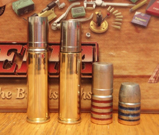

The .500S&W already has a long throat, the round on the left in the pic below shows the 700gr RR bullet seated to reach the lands in my rifle.

Dang Tim!  Who needs a rifle?  Just put some corn and the base of your ladder stand and drop the entire cartridge on the deer from about 20 feet up.  Game over.

« Reply #7 on: December 16, 2008, 11:17:51 AM »
The recoil from those puppies at over 1400fps is over 50ft/lbs, so you be sure and hang on good in that tree in case you decide to shoot it instead of dropping it.  ;D
