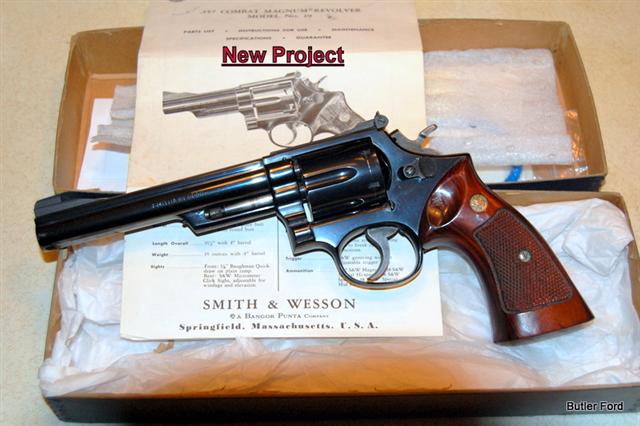

I've decided that this winters project is going to be a 6" S&W M19 and cast bullets.  I don't need to feel the earth shake when I let the hammer fall but at least some authority.
I'm looking seriously at the Lyman 358429, it's a 170g Keith semi wadcutter.
This project is at the research and procurement phase.  I already have a few hundred pounds of wheelweights and 4-5 hundred pounds of plumbing lead on hand. The Mod 19 has been found and the deal is done, just waiting for the funds/pistol swap.
I have located a 4 holer mould but can't find handles. Which brings the first question: Do RCBS handles fit Lyman moulds and if so, is there a particular model I need to look for?
I've learned something else as well!  I don't know if it is our new President-Elect or some other reason but new brass is hard to find!  I have some 357 and 38+P brass but would like to start with 500 to 1000 pieces of new.  I've never tried Starline so I thought I'd give it a try if I can find a source that's not sold out.
I have been a ladle caster for a few years but I think it's time to move on at least into the 20th century, of the Lee, Lyman, RCBS bottom pours, is their any real significant difference worth choosing one over the other?
Though I will slug cylinder throats and barrel, I'm betting sizing to .358 is going to be about right but if not I'll use that size die for other pistols and get the appropriate size die.
I'd like for anyone that would care to, to join in on this project as much as a forum would allow and I always like to show off if it goes well or have somewhere to seek help if it doesn't.  I never fail to listen to good advice or suggestions wether I heed them or not. I'm sure I'm going to need a bit of guidance from those of you that have already traveled this particular path.
Second question:  What kind of performance can I expect with this bullet?  I'm thinking of at or about 1100fps?
From what I can tell so far Lil Gun does this with the lowest chamber pressures. What can you tell me about the actual performance and characteristics of this powder?  Would 231 be better, worse or just another powder? Any other suggestions?
From what I can find out this bullet is a bit long but the cylinders in the 19 are long enough to accommodate it?
If 1100fps is doable (in respect to longevity of the gun) it is on the upper end of wheel weight velocity without a little help ie. adding linotype or heat treating?
Number three:  I have mostly used homemade lubes and I will admit with some success but I'm tired of that particular mess!  I did try some Lyman molylube with some 45 acp's and it worked well as a lube but was soft and messy.  Lube recommendations?
Any suggestions before I get any further?
I'm posting this in 3 forums because it is specific to all three-S&W, Casting and Reloading, so Bill, I hope you don't kick me out!
Thanks in advance
BF

Wasn't a good picture to start with but went south when I resized it!  Anyway here's my starting point:

They sure are pretty! Mine was nickel plated. Gave it to my 2nd ex-wife in the divorce. That loss was easier to live with than what she wanted!!! LOL!

Sure is a fine looking revolver, I should have my new project next week, A Ruger 7 1/2 inch .357 maximum, I hope to getting it shooting well with 180 & 200 grain hardcast. Its nice that you can share your projects here. More fun than doing it alone. 8)
Thanks Badnews.  You're absolutely correct, it is a lot more fun when you can share the projects!  Will be waiting news about yours!
