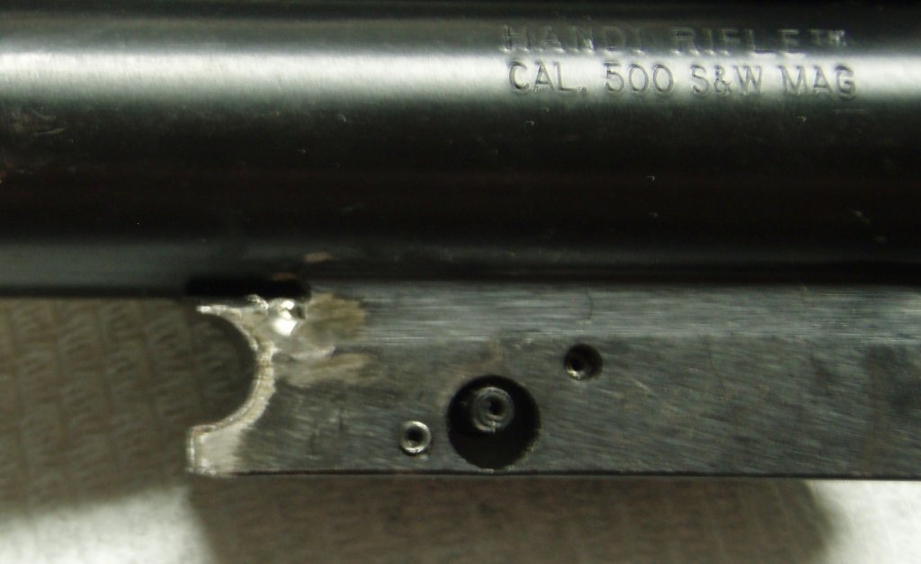

45north, I had to use a .026" stainless shim in one barrel that someone has cut so big it would have needed a .400" hinge pin, it wasn't just deep, it was way bigger!!  :o
Tim,
Can you post a pic of this barrel??
I have never seen one that had been shimmed and refitted.
I would just like to see how it turned out.

I don't have it any more, it was the 270 Ultracomp that I sold to Canon6, maybe he can take a pic if he still has it. The .500 barrel has a thick shim tho, here's a pic.
Thanks for the pic. Tim
That's what I wanted to see.
Spanky

I do not have the 270,Quick sold me, my oldest son has it. It will shoot into  1inch all day long with Rem factory(130 grs) if my son does his part.That has to be the thickess shim I have ever seen , but it does work.      Doug
