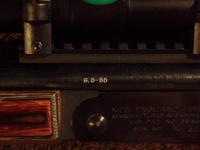

I finally got the 6.5x55 back from Wayne, he couldn't weld the underlug on, just too much work making a jig to align it, so he stubbed it and a fine job he did! The Shilen match barrel is 26ΒΌ" long, with an almost impercepible mating of the two pieces, I'm real happy with his work even tho it took 15 months. He said it would have been less, but he put it in a drawer and forgot about it, he told me it would be a back burner project, but if I had called and asked about it, he would have had it done much sooner!! ;D

Very nice Tim.   If you don't mind me asking, can you tell us what the final cost was to get it done?  Does this mean that he will now do stub jobs, or was this a one time thing?

He spent more time on mine cuz it was the first he had done, but said he'd charge $300 for future work with a donor stub supplied by the customer and blank cost on top of that. He may reduce the cost once he refines his techniques, but that's what it would be for now anyway.

I see you recycled the 300 WSM project barrel for yours.

Yeah, it was worth the $17 I paid for it!! ;D
