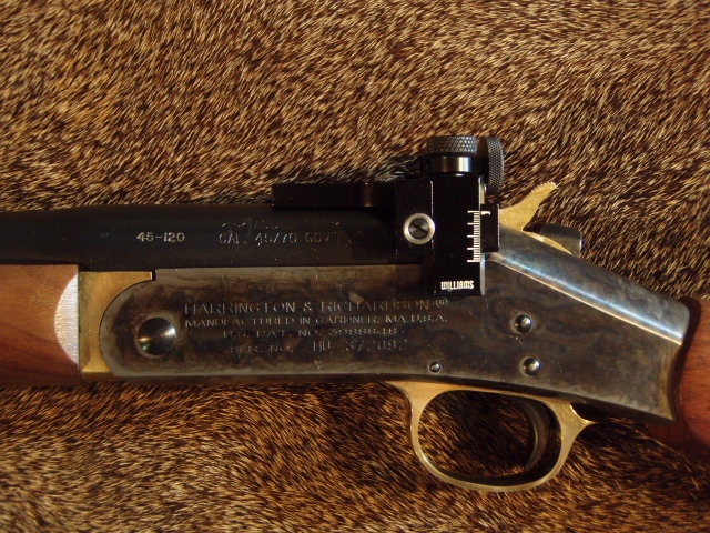

Mine came with the standard Williams slide adjustable sight for elevation and a dovetail for windage.  I've been looking around and I see that Williams has one for the BC that has a screw adjustment for elevation and windage.  According to some reports, this one will take it out to 500-600yds.  Unless I see something better and affordable, this is the one I will be getting.  Here's one that Midway sells.  http://www.midwayusa.com/eproductpage.exe/showproduct?saleitemid=165204&t=11082005

The ramped sight that comes on the BC is the WGRS, it's an ok hunting sight, but adjustments are somewhat crude, with a .404" tall front sight which is considerably lower than the .494" or .584" 17A sight that comes on the BC, you can get past 300yds, but the FP sights are good for 600yds+ even with 500gr bullets at 1500-1600fps.
The Midway link is the FP, do yourself a favor and get the FP-TK, it has Target Knobs for adjusting and Williams has knobbed set screws to do away with the need for a screwdriver to loosen the elevation lock screw that both FP sights need.
http://www.gboreloaded.com/forums/index.php/topic,72579.msg446036.html#msg446036

Great advice quickdtoo, I'll do that.  I've seen someone else on this forum, maybe you, mention the shorter front.  I'll get that too.
