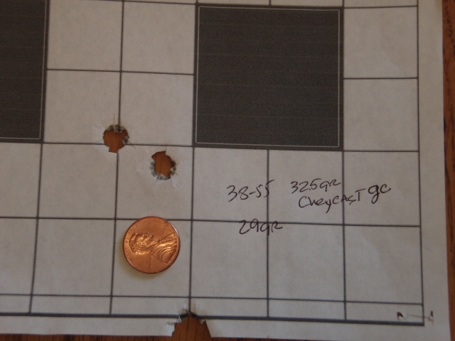

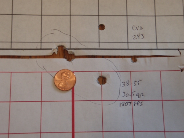

The 38-55 did Ok with the .380" Cheycast Snovers that I gas checked, but nothing outstanding, dunno if my home grown gas checking is the cause, but most groups would throw the third round low and out of the group, the best group was with my max load of RL7 and a little over 1800fps, the first two rounds at ¼" and the third low opening the group to 1¾". The other funny thing was the POI dropped with each succesive .5gr increase in powder instead of climbing!! ???
Also shot the Optima Elite 243 with factory ammo, it shoots good enough that it and my thumbhole Ultra Varmint are getting reamed to 6mmAI. ;)
30.5gr
29.5gr
