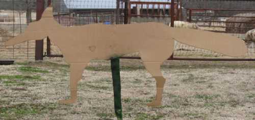

A month ago, I had bought the wife an Upright Freezer, and from that big Cardboard box, and wooden slats, I cut out (4) life size
Coyote Targets, split the slats into (4) stakes, and stapled the targets to them.     Because of the wind and lack of time, I set 3 of
them up at 50 - 100 - 150 yards.   A few quick shots  for each target just to see how it shoots.   They all placed in the kill zone,
but the 150 yard target I had drawn a little heart on it to give me something to aim at.   That lil .223 tagged it.   Made my day.
I'll have to do that again when I have more time and a camera.   I want to set these up out to 300 yards and put several rounds
into each target.

My current CZ is a 527LUX, w/Leupold 2-7x33 Compact in Burris rings:

That is the most fierce Coyote that I ever did see ;D ;D ;D Good job and great shooting.
