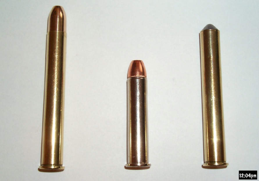

So I'm interested in some shot loads for my 45-120.  It will be able to hold a large amount of shot, enough to be useful I'm hoping.  How can I keep the shot from fouling my bore however?  My first load idea was 20 grains Unique, a wad of some sort, shot, then another wad that was kept in place by wax or something.  I'm worried about shot leaving plenty of lead in the barrel.  I have seen the shot capsules for 45 Colt, but I could probably fit 3 of them in a 45-120 case, they would get expensive if I shot many  of them.  Any other ideas to keep the shot from touching the barrel?  I figure I might even get close to 3/4 of an ounce of shot in that cavernous case.  More than a .410 I'm guessing at least.

Wow, that would hold a lot of shot! :o

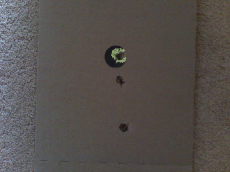

2.5 grains Unique with a round ball on top of the powder=enough to kill a sparrow, but not enough to penetrate into a apple juice jug filled with water. :o
Offline tykempster
  • Posts: 798
Re: Shot loads in a rifle
« Reply #21 on: July 21, 2008, 01:15:49 PM »
5 grains still doesn't go into the apple juice jug.  8 grains is supposedly around 1200 fps, so if we guess and extrapolate 700 fps, I can't believe it doesn't go into a water filled jug.  2.5 grains is slow, slow, slow, you can see it flying in the scope.  Both go through 1/2" of plywood.  Here's a 3 shot group at 25 yards from the sitting position.  The real low one sounded like water filling up a hose, blooooooop!  It looked pitiful through my scoped view.
I don't have any cast bullet lube, so I used a bit of Lee sizing lube.  The ball goes right on top of the powder, tamped down a bit like you would a muzzleloader.  Obviously there are some inconsistencies.  I take out my primer with a 45-120 die so I don't resize the case.  A resized case won't even let the ball past the mouth of the case.
