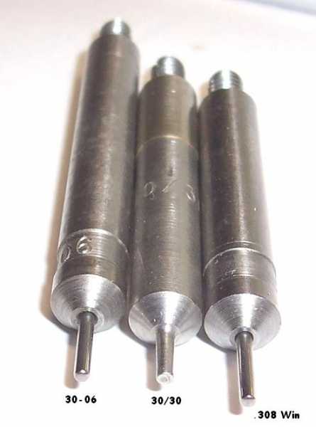

Recently purchased a LEE 30/30 Win. Case Length Gauge and have struggled with it through a bag of 50 Winchester cases. I've used Lee case length gauges for years and this is the first one to give such trouble. The pin on the end seems to have been turned down from the original pilot metal rather than the usual inserted hardened steel pin that my 8 other gauges have. The actual length has decreased enough that the last few of the 50 cases that I trimed were a few thousands under the first. The OD of the pilot is also larger than the other .308 caliber gauges.
Here's a picture of the 30/30 gauge between a 30-06 and a .308 showing the difference. Anyone ever seen a LEE gauge like the 30/30 here?

If it is truely one piece and not an insert then how would the length change? Was the end flat or round when you started. The new pine also looks tapered. I would say that the pin is too wide to go into the primer hole all of the way and that the more you use it the more pressure you are using pushing it further down into the primer hole. Did you measure the case cut lengths and are they within specs?

The separate pin is a hardened material and doesn't wear as much as the gage itself, I've cut down gages for use in chamberings that Lee doesn't offer, the body is easy to file, but the pin is hard and requires grinding to shorten the length, a file doesn't work well on it. I'd rather they charged a little more for a gage with a hardened pin than to be concerned about them getting too short to trim to proper length.  :-\

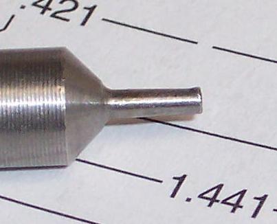

It is indeed one piece now. I've tried to photo a closeup view of the area on the end of the pin that has actually mushroomed as if peened with a hammer. This if from hand pressure only.
The pin will fit into the flash hole.
Bill

Quick Fix- put a small weld on tip, quench in water quickly, will be somewhat harder, grind to proper length.  Better fix- cut off tip, redrill pin hole to accept a "needle bearing" pin from an old roller bearing. Made one for my 357 max from a 35 Rem case length gauge, works great. Those pins are harder than factory pins.
