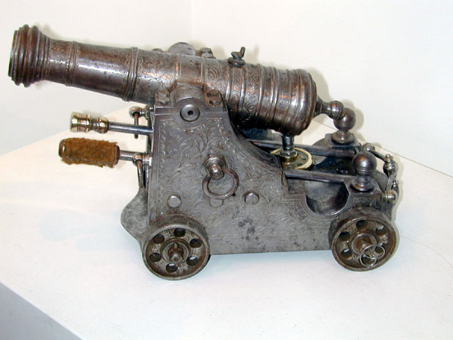

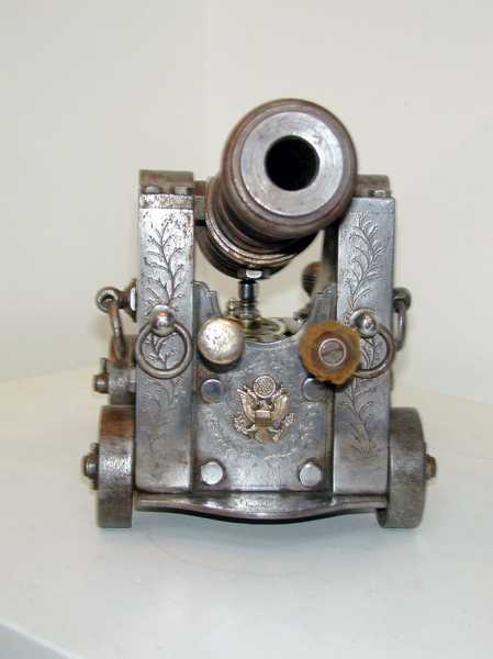

sh1bby69, I don't remember where I copied these pics from, I think it was from an eBay private auction house but this is the info I took from the site: Engraved steel 13.5" long 19th century. I would guess your gun was either made by the same craftsman or if each cannon is made by different craftsmen then one of them certainly had intimate knowledge of the others work. What caught my eye originally was the unusual design of the carriage, the wealth of detail and the nicely done amateur engraving; I'd never seen another gun quite like this one (until I saw yours). The brass U.S. Great Seal medal (or pin) attached to the front transom looks to be original with the piece, which might suggest it was made by an American machinist in the 20th century. If this gun was listed on an eBay private auction, it would have had a low and high estimated worth given and if thats the case, I didn't make a note of it, probably because those estimates sometimes seem farfetched but if I was lucky enough to own one of these guns I would certainly hang on to it, I really admire them.
Offline sh1bby69
  • Posts: 13
Re: Model Cannon Help
« Reply #52 on: June 10, 2008, 04:07:11 AM »
that is very awesome!! Mine looks exactly like that except a few differences. Mine is also missing the cleaning rod as well but still that is really cool information. Do you know where I can find more info on it?

You guys need to get your magnifing glasses out out.  Engravers often sign their work in unobtrusive places.  Look at endings or edges, or places that would not distrub or lack symmetry.
