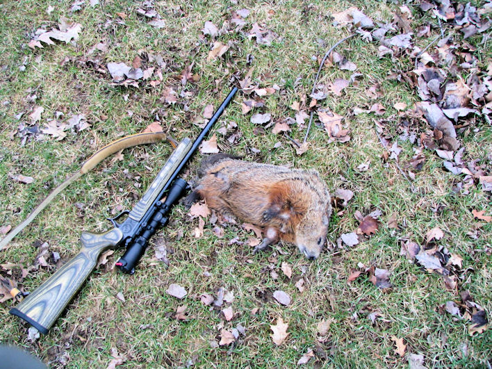

I shot my first woodchuck of the season today. I popped him with an old Contender with a 23" barrel in 221 Fire Ball. I was not a long shot and laid him right out. I could not find the entrance hole and there was no exit hole. I really like the 221.

Cool!
There is one living under my porch that I hope to put on ice soon.

I had seen this one every day this week, but today was the first time I got a shot at it. :D

I was hoping the necks wouldn't need turning. That means i need to buy more stuff and i just don't have that much time, so i guess I'll pick up new brass when i find it. My barrel that i got from midway worked from the get go. I got the black syn stock and small forearm. i had to open up the channel on it for the barrel fit all the way down. i read later that i needed to go with g2 forearm? I like the one on yours can you get it in black syn?  I know this was off 1st woodchuck of the season, but your the 1st guy to post with a gun like mine and i was needing info on how other was working out. thanks

221 fireball- I got the stock and fore end at Boyd's. They make wood/laminated stocks - no synthetic ones. It looks like they are discontinuing these  >:(
Here is synthetic one from Mid South
http://www.midsouthshooterssupply.com/item.asp?sku=000307735
You can get one like mine (that is being discontinued) and paint it with bed liner spray to give it that look and feel of synthetic.
http://www.midwayusa.com/eproductpage.exe/showproduct?saleitemid=714597
