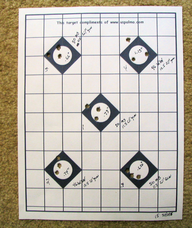

I shot a few rounds out of my 22 Hornet SL this AM. I shot it off of a Caldwell Lead Sled, the one with all of the adjustments. I adjusted so the front bag was under the frame. I can get better groups off of bunny bags, but the Caldwell is so easy to use and really tames the recoil of this gun ::) I made up 2 loads. Both had virgin WW cases and 1 1/2 Remington small pistol primers. The first was with Miid South Varmint nightmare extreme 50 grain premium bullets and 11.5 grains of Lil'gun loaded to 1.820" OAL. The second was with WW 46 grain HP loaded with 12.5 grains of Lil'gun with an OAL of 1.720". I would like one of these bullets to work out because they are cheap. More on that later. I loaded up 25 Mid South 50 grain bullets and 10 WW 46 grain bullets. I had to zero the scope so I bore sighted it the old fashion way at 25 yards. 3 shots and I was a little high. Shot some groups and showed a little promise, but nothing ecstatic. I checked primers and cases for over pressure signs...looked very good. No cratering or flattening of the primers, the cases show the usual slight bulge just above the web. I will be neck sizing from now on. No problems with case extraction; they popped right out in my hand. A lot of vertical stringing. It looked a little high so I made another adjustment down. The last 3 shot group at the sight in target was .62" with the Mid South bullets and centered in the target. I shot a total of 14 shots at the sight in target. I moved back to 50 yards (my 100 yard target stand is surrounded by water and ice right now). I shot 5 three shot groups. Three with the Mid South and 2 with the WW bullets. I shot a total of 29 rounds counting the sight in target and this one. No cleaning between shot strings, just load and shoot. BTW the ejector is very nice with gloved hands. See target below.
I have them numbered in the order shot. The Mid South bullets show some promise and I will be working with them some more. I bought 500 of these @ $36, the best bargain I can find on .224 bullets. I got the WW 46 grain bullets given to me as pulls. I do not know if that had any significance or not with the accuracy. I will vary the powder charge with the Mid South bullets on the next trip out. I have no idea how these bullets will perform on groundhogs. I am not sure I can push them fast enough to expand. I am estimating my MV @ 2650 based on Speer loading data. If these bullets do not work out, I am going to try some of the 35 grain Hornady V-Max and 36 grain Barnes Varmint Grenades. They cost twice as much as the Mid South bullets - OUCH!

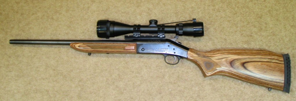

Here is a pic of my Handi "Ultra" Hornet. It weighs in at 6.8 pounds as seen. A little butt heavy, but not bad. When I sent it in I had them do a trigger job. It is still a little stiff for my liking, but I am going to work with it a while this way. I did a trigger job on my other "true" Ultra and it is crisp and about 2 pounds. I have pillar bedded the fore end and added a piece of inner tube under the barrel at the end of the fore end. The rest of the fore end is free floated. She opens stiff and feels solid. ;D

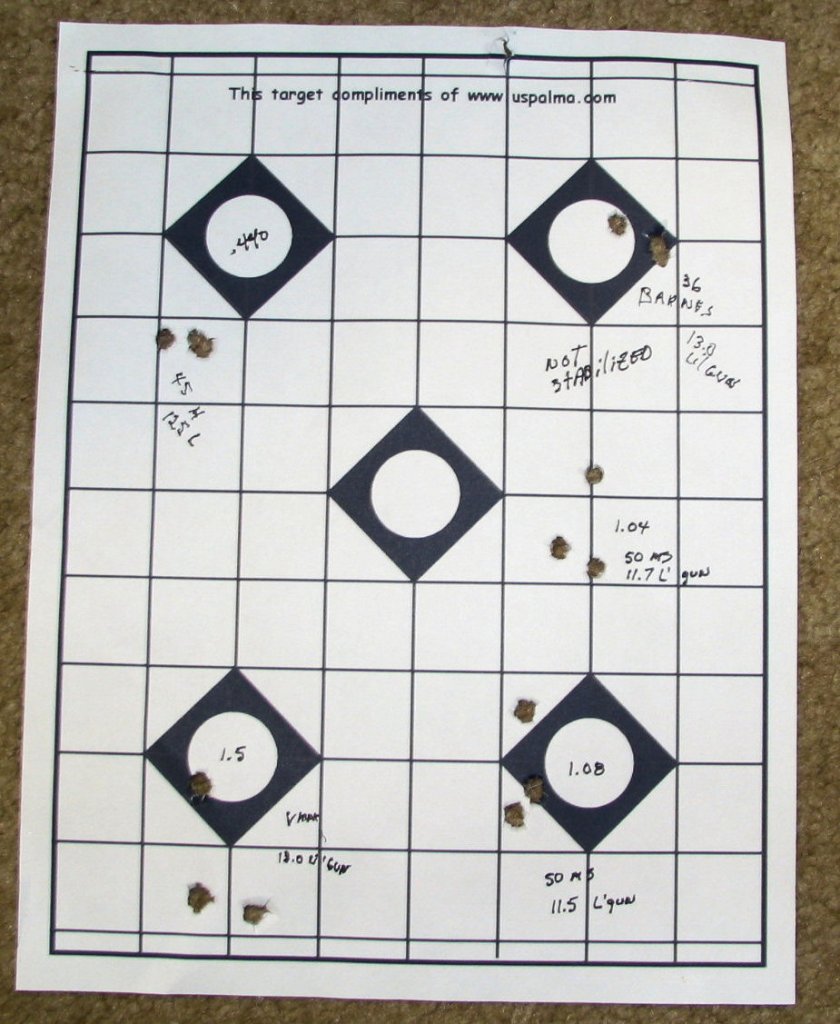

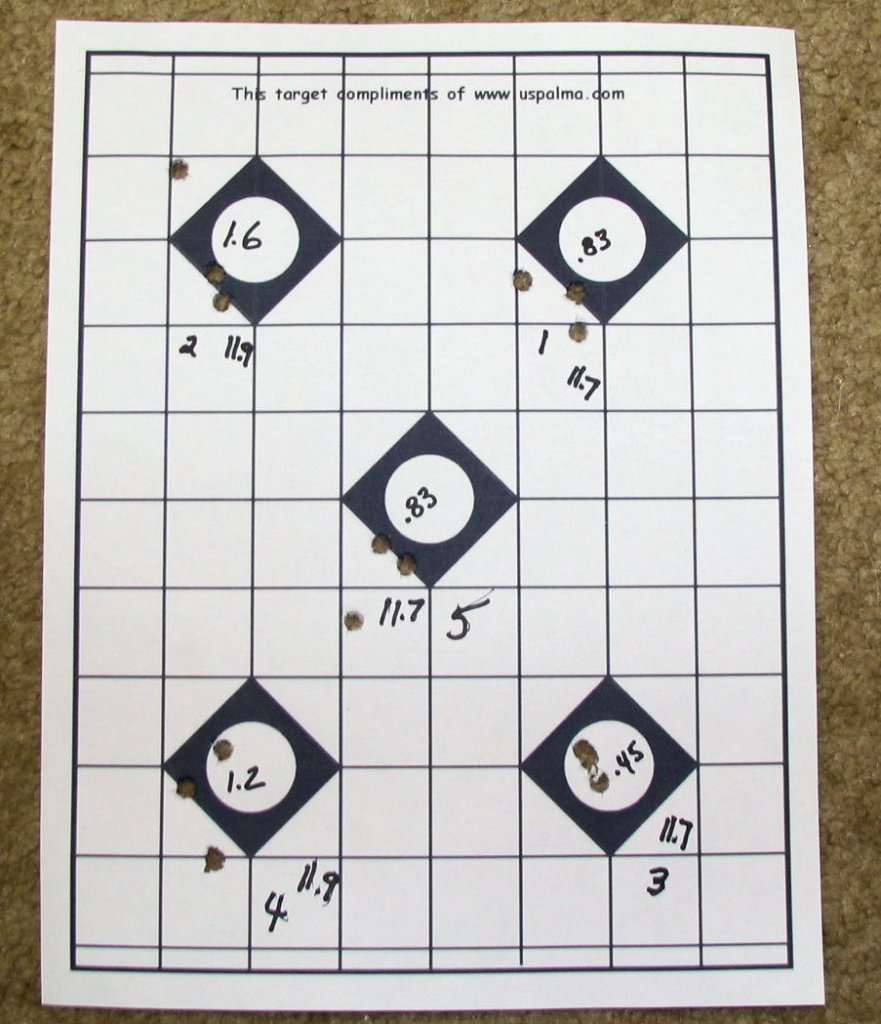

Update - I did a little more shooting this AM I had some 50 Mid South bullets to the same OAL loaded up with 11.7 and 11.9 grains of Lil'gun.
Notice shot string #3 I guess a blind man finds a piece of bread once in a while. One thing that puzzles me is the shift in center. I will check the mounts and see if they can be loose. On several occasions I get two close together then get one going off. #3 is in the middle of the "eye" but #1 and #5 are to the lower left, with the same load. I am going to cross the 11.9 grain load off my list.

Assuming the latch and shelf are clean and dry, it could be the latch and shelf just aren't well mated yet, so lockup isn't identical each time. Try this trick, put a little flitz on the latch shelf and cycle the action a bunch, then clean it off.  I've tried valve grinding compound, but I think it might be too aggresive, something in between would be better I think.  ;)

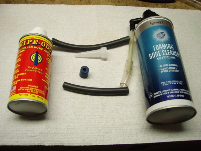

I will try that Tim. I have 59 bullets down the tube and can't stand it any more. I was going to shoot this with out cleaning very much, just have to, habit I guess.  I have a second application of foam in her now. I ran a few 40 V MAX down the tube this AM and did not get very good results. I have a lot of vertical stringing, but not always. It could be the latch lock up. It locks up real tight and I snap it shut each time. I have not checked the mounts yet, will do after I get it cleaned up. despite the larger than wanted groups, I do have a good feeling about it. I really do like the rifle. Since I am talking about the foam, I inserted a smaller OD flex tube in the foam tube. I was getting a lot of foam coming back out the breach. Now it all shoots down the barrel like it should. It is about .25 OD; it seems to fit into the chamber much better. The original one had to stretch a little to get it in. I think I will have two cans going, one with this in it and one with a larger diameter tube stuck on it for my 35's and 44's.

I have several different sizes of tubing to work on different rifles/chamberings, put whatever together that fits right, put a 1 liter pop bottle over the muzzle to capture the excess and use it as a liquid on patches. ;)

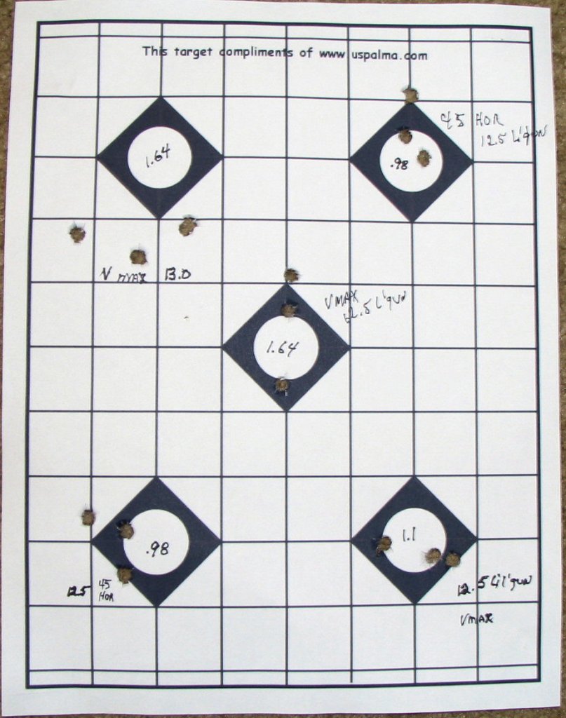

Another Update - I found some Hornady 45 grain Hornet bullets in my stash. Naturally I had to try them. I loaded up 9 of these with 12.5 grains of Lil' Gun. I also loaded up some 40 V MAX with 13.0 grains of Lil'Gun. Also some 36 Barnes Grenades with 13.0 grains of Lil'Gun and 12.0 grains of WW 296. I finished shooting through the entire 100 cases that I had primed with Remington 1 1/2 primers. I now have 100 rounds down the tube. I think I am going to abandon the Mid South 50 grain bullets even though they shown some promise because of doubtful expansion at Hornet velocities. I still have not found anyone or seen any thing about the performance of the 50 grain Mid South bullets. I probably will regulate them to my 223's. I added another piece of inner tube under the barrel. I expected the POI to change up and it did. My first shot barely touched the target at the top. I made adjustments down and the shot at the lower right diamond. Notice the three shoots  to the right center of the page. So I made another adjustment down and was in the ball park then.
I then shot the group in the upper right with the Barnes bullets. I though I really had some thing going here. More on that latter. I then shot 40 V MAX and 3 more Mid South bullets. The 45 grain Hornady Hornet bullets was the last one I shot on this page. It was .44" - Looking good. I moved to the next target.
I shot another group of 4 of the 36 Barnes this time with 12.0 grains of WW 296. I could not find it on the paper. upon closer examination, I found 4 holes in the wood below the target that were in various stages of going sideways. Cross the WW 296 of the list. I still had high hopes for the 13.0 grains of Lil'Gun look at first target. I then shot a V Max Bullet with 12.5 grains of Lil'Gun. I then went back to the Barnes 36 grain bullet. Shot three times and never hit the target. I then looked at the first target closer and now I think that one bullet missed the target, one went in sort of straight and one key holed. Cross the Barnes of the list. I shot alternating 40 V Max and 45 Hornet bullets for the next four strings. I was getting horizontal and vertical strings with the 40 grain V MAX bullets???  I think I am going to cross off the V MAX bullets too. With the 45 grain Hornady bullets, I got one decent group and the other two were at least groups that were under an inch. I am going to neck size now and load up some different primers and work on the 45 Hornet bullets with Lil Gun powder. I think I will try some of the WW WSPM and some WW 6 1/2 small rifle primers (yep they are old). I do not know how the WSPM will react so I will drop down the powder charge to the bottom and work my way up. I will prime and load 9 at a time (3 - 3 shot groups) to see how they do. While I have found that sweet load yet, I have found some things that will not work. I do not know when I can get back to this, but will report when I do. I really do like this gun, It sure feels solid. I do not think that the extra piece of inner tube made much difference in the she shot, so next time it will be 1 thickness again. I will have to adjust the scope back up now as it will probably shoot too low.
